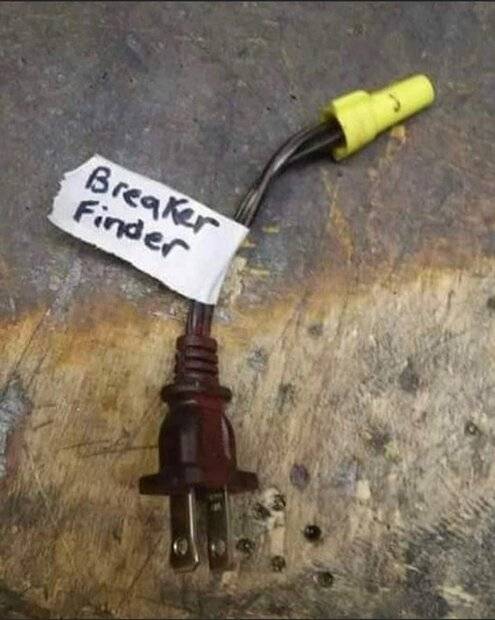

This circuit breaker finder just popped up on reddit. Works every time. Amperage guaranteed high enough.
