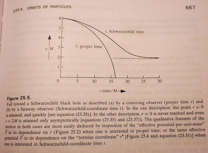

This figure from the Gravitation by Misner, Thorne, and Wheeler shows how the falling toward the EH is "seen" in the two frames:
Pony said:
it would be weird to watch an object and seeing it to disappear
Actually, the outside observer would see the falling object to disappear, although not as it crosses the EH, but rather as its signal gets red-shifted to a level below a finite sensitivity of the observer's instruments.
Indeed. Classically, the object is in principle visible forever in the sense that the external observer can always trace a null path back to an event on the object's worldline outside the horizon. But light coming along such lines will be increasingly redshifted and dimmed as the object approaches the horizon, so it fades from view.
