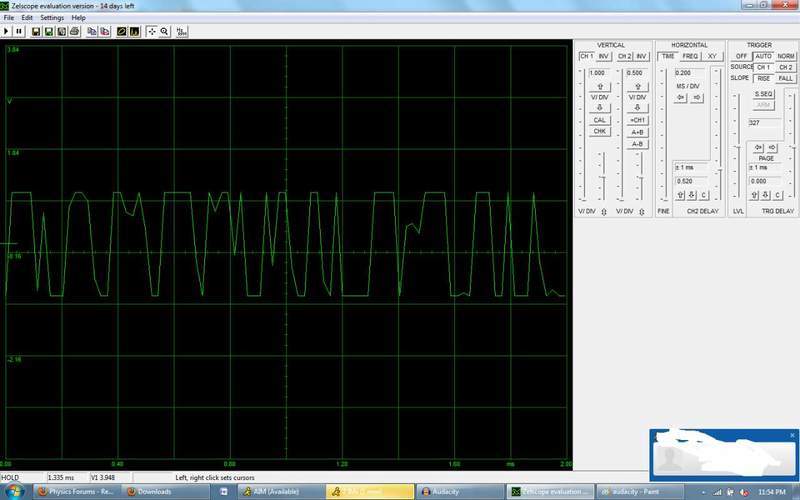

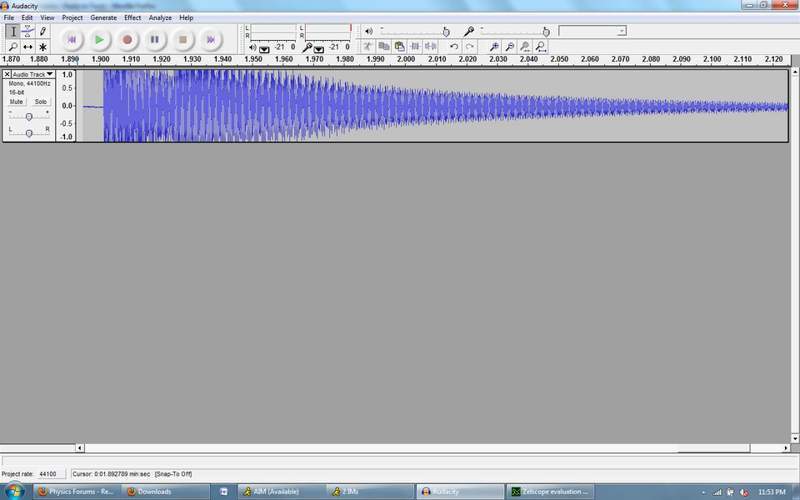

Hi, I did a test, with audacity and a computer oscilloscope and got some nice waveforms, but I am not sure how to analyze these waveforms to determine what the resonant frequency is? I tapped an empty wineglass with a spoon near the microphone and got these:

The second image looks useless. Either it is saturating (signal is actually too loud) or it is not sampling fast enough or both. The first image looks like it might be good but you need to zoom into a small segment.
You should see a decaying sinusoidal waveform. You should be able to then determine the period of one cycle.
Zoom in, measure the distance between 10 peaks of the waveform and divide by 10 to get an average period. The frequency is then 1 over the period.
Can you post a zoomed in image from the audacity sample?

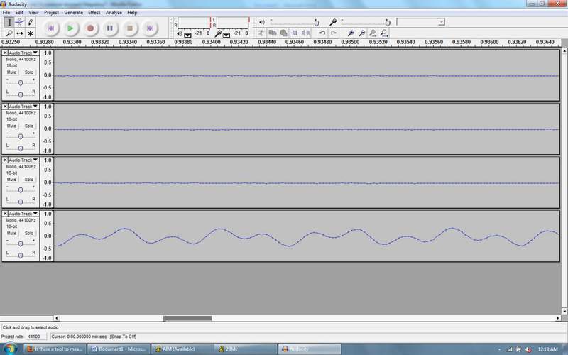

I do see part of a sinusoidal waveform. As seen in the last recording in the screenshot.
Don't I need to do a spectral analysis or something?

Analyze -> plot spectrum

Is the value of the first peak the resonant frequency then?
