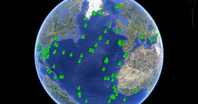

I've found it very useful to be able to create your own placemarks in Google Earth and Sky. Is there a way to do something similar in Stellarium too?

I sounds like the OP wanted to bookmark star locations in order to return to them more easily.

Just as Borg says. Like these pins in Google Earth.

I just found the answer - there is a way.
I was fiddling around in Stellarium and wondered if there might be a keyboard shortcut to doing this so I began trying different various of using the CTRL, SHift, Alt, and the right and left mouse buttons. It turns out that Shift+left click will add a marker where the mouse pointer is.
As Emily Litella would say, "Never mind!" Gilda Radner from Saturday Night Live reference
BTW - FYI for anyone who may stumble across this in the future, I've also found out that there is currently no way to rename these custom markers. Therefore, unless a bunch of markers named Marker 1, Marker 2, Marker 3, etc. would be useful to you, using this not-ready-for-prime-time* feature won't be useful for you until it is fully developed in a future version.

This is admittedly a necropost (sorry), but in case anybody is still interested, here is the answer:
Stellarium now has a "bookmark" feature that allows you to easily mark and access objects and locations of interest.
To enable the bookmark icon on the lower tool strip, go to:
Configuration ==> Extras (tab) ==> Bookmarks (checkbox)
Once the Booksmarks checkbox is checked, a new icon will appear on the bottom (lower) toolstrip. The icon looks like a 5-pointed star on a pennant/banner/flag. Clicking on the icon opens the bookmarks window.
From there you can add a booksmark corresponding to your currently selected object (or delete existing ones). You can Go To a bookmark, essentially selecting it as your new selected tarket. You can also "highlight bookmarks," which gives them the same sort of functionality as the pins in Google Earth, such as the OP was inquiring about.
Unfortunately, I don't see a way to rename them or add any descriptive text to bookmarks. But at least they're there.
