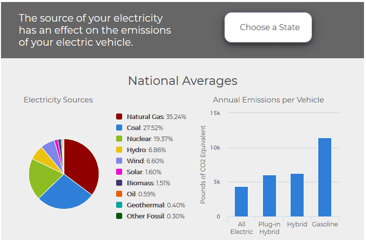

Ygggdrasil said:
There are still environmental benefits to EVs, however, as burning fossil fuels in a power plant to generate electricity to power a car is overall more efficient and produce fewer emissions than burning gasoline in a small car engine.
Are you sure about that?
Ygggdrasil said:
In fact, given that coal power plants are much more harmful to the environment and human health than gas-powered cars...
Seems to contradict the above? I really don't know what the relative emissions are.

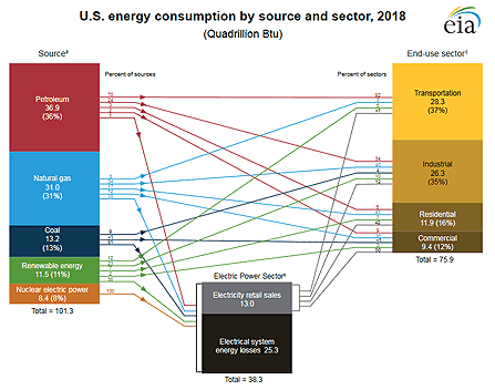

I'm not so sure about that. Here's a little exercise that surprised me. Look at the energy transfer rate when filling up your car at the gas station. If you pump 15 gallons in say, 5 minutes, that's 3 gallons per minute. Gasoline has 114,000 Btu per gallon, so you are pumping 342,000 Btu per minute, or 20.5 million Btu per hour. That's 6,000 KW passing through the filling hose! Now its true the electric motor will be, say, three times more efficient than the gasoline engine, so you need "only" a 2,000 KW charging line.
Of course, we don't have to re-charge the cars as quickly as we re-fill the gas tank, but still
Replacing the gasoline we use in our cars with electricity is a great idea, but I don't think "minimal infrastructure change" is the right word for it.
Here's another exercise. Google says the US consumed 143 billion gallons of gasoline in 2018. Using the 114,000 Btu/gallon, that works out to an average consumption rate of 550,000 MW. Applying the factor of three its still 180,000 MW. Compare that to the total US electric generation of 3.82 trillion KW hr per year = 435,000 MW. So we'd need to increase electric production by 180/435 = 40 percent. Not trivial.
Here's a figure from the US Department of Energy:
(source: https://afdc.energy.gov/vehicles/electric_emissions.html)
However, it is true that in certain regions of the US with high usage of coal (e.g. in WV where electricity is produced from >90% coal), EVs offer minimal emissions benefits over gasoline engines.
That's approximately correct. Maybe only 33% in terms of MWe capacity. Maybe more than 50% in terms of money. More on the money side because every distribution line every transformer on every street, nearly every electric service entrance in every home would need to be upgraded if all transportation was electric.
It used to be that electric power required 25% of all capital investments in the USA. I've been unable to find a recent number. So the infrastructure investment challenges associated with EV takeover are huge. If done in time as short as one decade, it means really massive spending.
Edit: This figure can help the discussion. Source
https://www.eia.gov/todayinenergy/detail.php?id=41093

One point - the EIA’s 11.5% renewable number includes hydro and biomass. solar and wind, where the growth of new generation capacity is, accounts for about 3.5% of total generation
Likes russ_watters and anorlunda

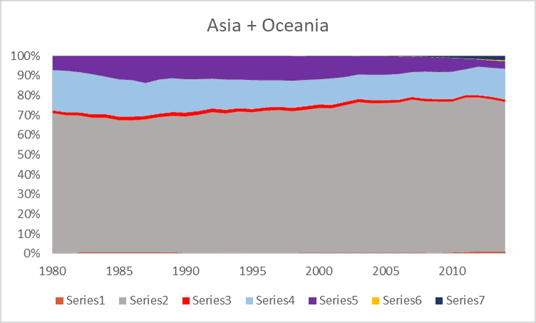

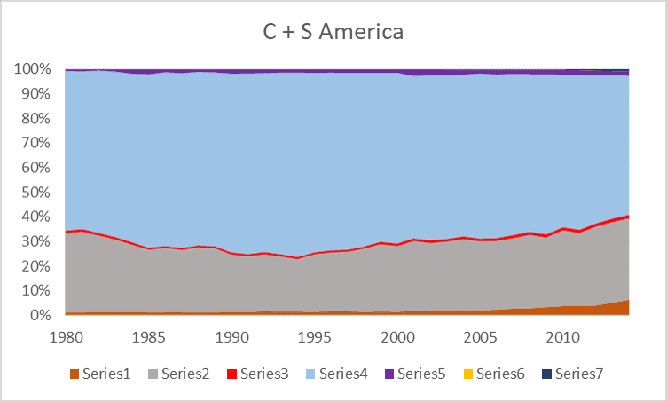

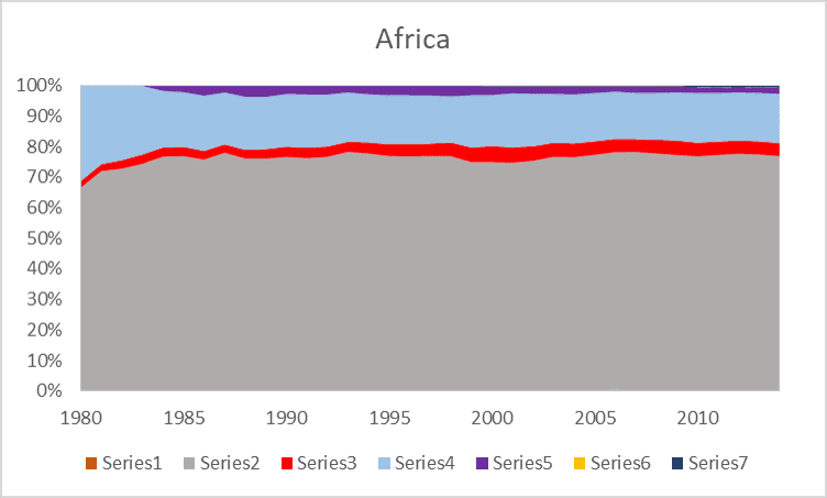

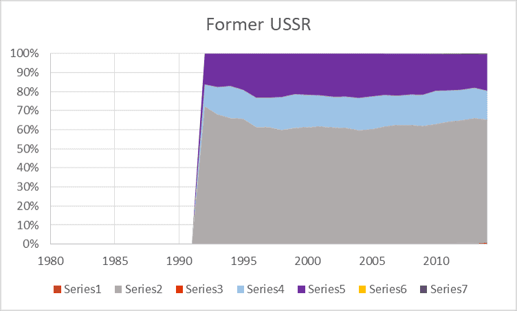

That EIA figure from #23 is very useful. Does anyone have a link to analogous breakdown for the EU? How about one for the entire planet?
Likes gmax137

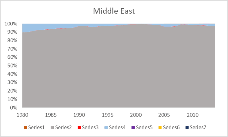

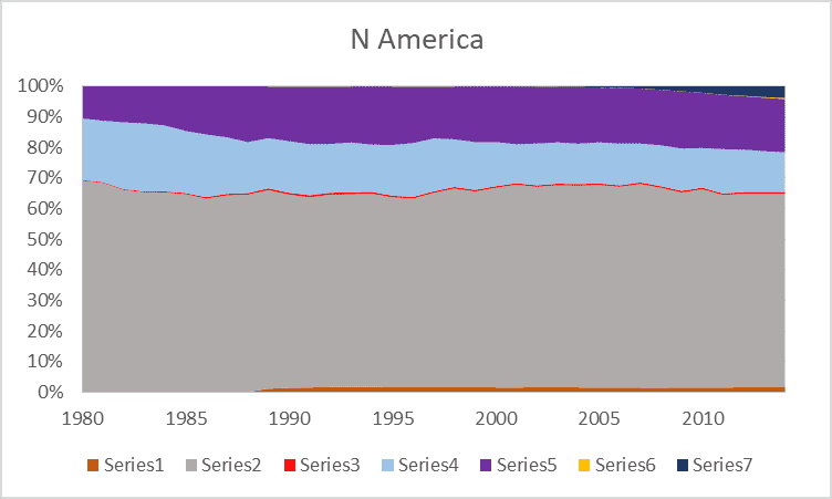

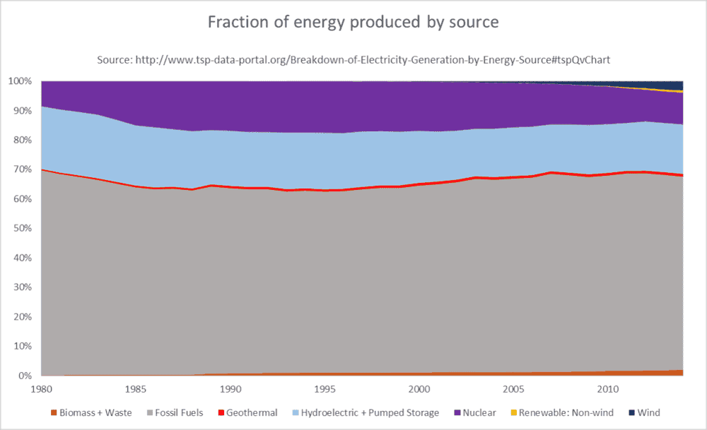

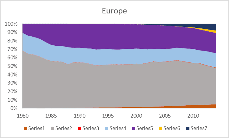

I made these a long time ago, they're at least a partial answer to your question.
(Key and link are in the "world energy use" file.)

Got a request for a link to the source of the data in post #26:
http://www.tsp-data-portal.org/Breakdown-of-Electricity-Generation-by-Energy-Source#tspQvChart
