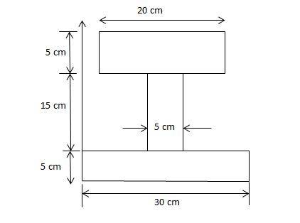

Find the moment of Inertia of the cross-sectional area of an I section about its centroidal axis.
##I_{XX1} = I_{.G1.X} + A_{1}.Y^2##
Find the moment of Inertia of the cross-sectional area of an I section about its centroidal axis:

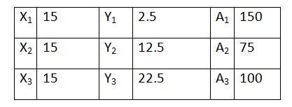

Sol: Here A1, A2 and A3 are the areas:
244991
244992
Centriod ; ##X_{C} = \large \frac {A_{1}X_{1} + A_{2}X_{2}+A_{3}X_{3}}{A_{1} + A{2}+ A_{3}}## ##= 15 cm##
Centriod ; ##Y_{C} = \large \frac {A_{1}Y_{1} + A_{2}Y_{2}+A_{3}Y_{3}}{A_{1} + A{2}+ A_{3}}## ##= 10.96 cm##

What is the axis of rotation ? Where is the centroidal axis located in the drawing ?
X, Y = 15, 10.96

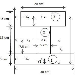

Can you tell how ##X_{2}## and ##X_{3}## is ##15##?
As in the diagram of the other question, horizontal displacements are not shown, so you need to assume all three shapes are centred on the same x coordinate. If the origin is the lower left corner of the bottom rectangle then that coordinate is 15cm.
What does centred mean? centroid of 3 shapes lie in same point?
On the same x value, i.e. a vertical line
