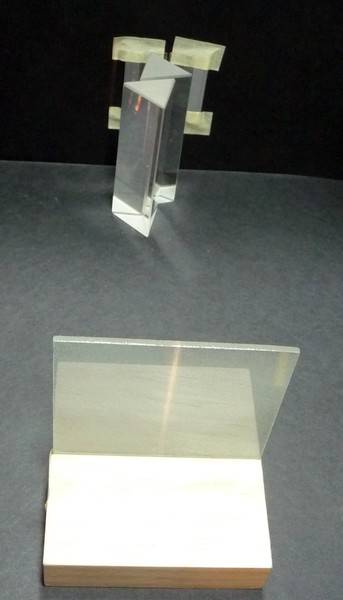

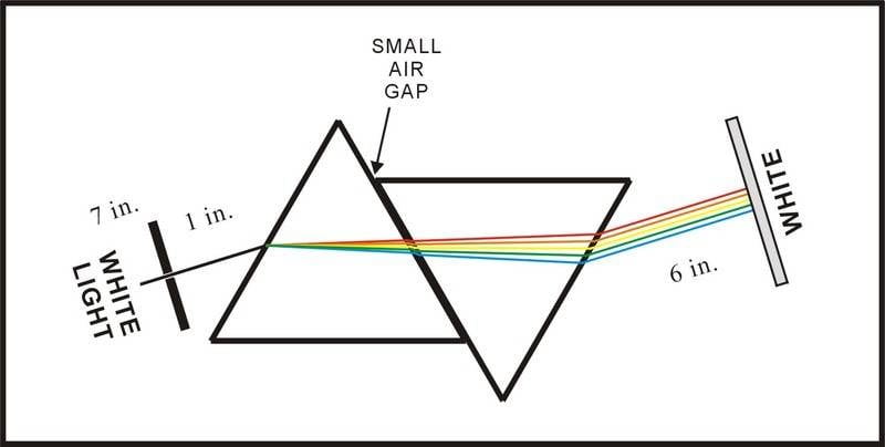

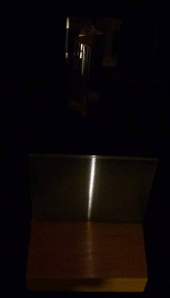

If extending the FTIR situation to prisms is valid, this might be informative.
(about 40% down the page from: http://blog.teachersource.com/2011/11/26/two-prisms-four-demos/)
RECOMBINING SPECTRUM COLORS
Isaac Newton also wondered if the colors of the spectrum could be recombined to again make white light. To do this he used a second prism arranged as shown. He proved that this was possible. What’s interesting is that the light beams exiting the second prism are not on the same line, but they are PARALLEL. And, because the slit is not infinitely narrow, these beams are not infinitely narrow and therefore can mix to create white light.
