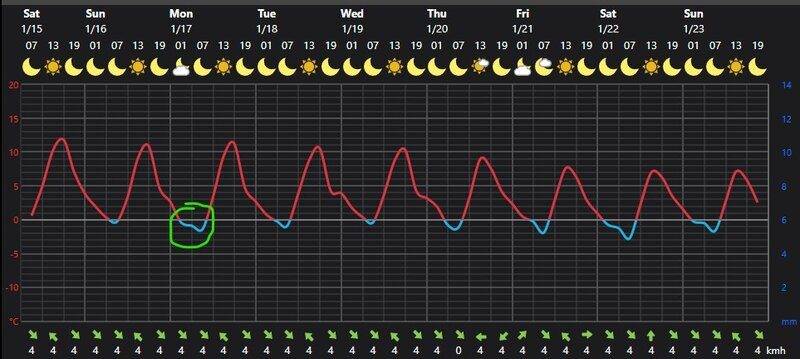

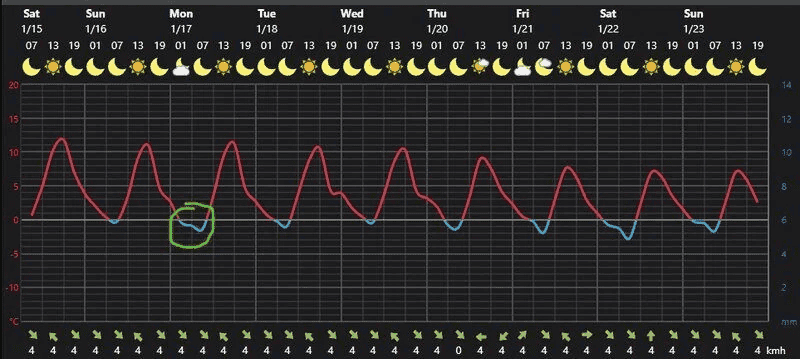

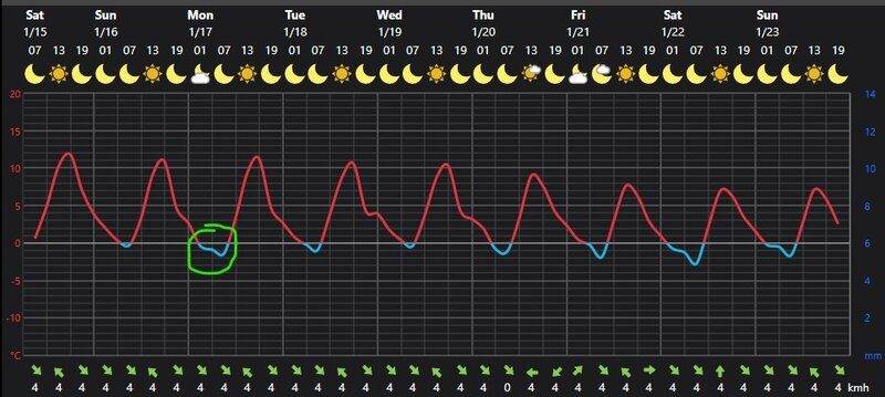

Hi,
I notice from the graph that every night when the temperature reaches -2/-3 °C the curve change first the slope and then the concavity.
Is something special happening?

You mean: like freezing ?
Likes 256bits and Vanadium 50
ahahaha, yes for example. But why does freezing should cause that weird shape?
I have no idea of the circumstances that resulted in your graph.
Heat radiates off into space at a certain rate. During freezing the temperature of liquid water remains constant. An air temperature of -2 or -3 degrees C provides a reasonable driving force for a while until all is frozen and then the temperature can drop further.

Besides freezing/melting (of water) and heat of fusion, there are mechanisms of heat transport: conduction, convection and radiation, as well as temperature of atmosphere, structures and ground.
Where is the thermocouple located? Is this a government weather station, a private instrument, or a personal system?
Guess: frost is happening. And with that comes some heat, so the transition between the + and - range is a bit slower.

Do you you have dew point data that corresponds with this temperature data?
That screenshot that you posted is very confusing. Could you please post the complete context of that screenshot? If it is from a website, please post a link. If it is from your personal weather station, please post a link to the user manual. Thank you.
For example, the plot changes color when it goes below the 0C axis, but that color corresponds to the atmospheric pressure or whatever the heck is displayed on the right vertical axis.
Indeed. What is the right axis representing?
What parameter is 6mm at 0C and 0mm at -20C?

More unusual things to note:
  • Wherever this is (Cuorgnè, Italy?), the wind speed is astonishingly steady (except Thursday AM).
  • This data is either predictive or it is at least 11 years out-of-date (possibly as much as 28).

DaveC426913 said:
Wherever this is, the wind speed is astonishingly steady (except Thursday AM).
Yeah, I almost replied that his wind sensor was frozen in place, but then saw a couple datapoints that were different direction or zero. But the near-continuous 4mph data is pretty indicative of a broken home weather station, IMO...
Likes Astronuc
Or mounted inside a shed** or something.

Precipitation is measured in mm.
For the graph, precipitation scale is at the right.
Looking at the daylight hours,
three times as many moons as suns, if that represents direct sunlight
the location was either somewhere 50 deg north latitude,
or,
the situated in a valley.
Cuorgnè, Italy
Yes. that would make sense.
Wind travels up and down the valley, changing direction during the day versus the night.
The location is going through a calm period with little precipitation - clear skies - and very little wind.
Notice only the one period with designated cloud cover.
During precipitation, temperature usually runs steady.
Although it cannot be deduced if that is the case here, as the graph shows no afternoon light snowfall or light rain.

This is the link I used for the screenshot
OK. We were all wrong. About everything. :frown:

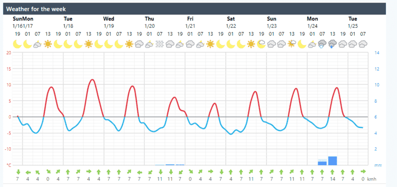

OK, the right axis is precipitation, but it has nothing to do with the blue curve.
It just happens that there is no precip in Cuorgnè during the period. Here's a graph for Toronto for comparison.
The upshot is that we can now contextualize and dismiss irrelevant artifacts in the OP's screenshot, leaving us to concentrate on the double trough of the air temp as it goes below 0C.I think my Toronto example is too different to be useful. It doesn't get near 0C this week, and certainly does not vary like that over a day. Here is a better example of a city whose temperatures are largely controlled by day/night cycle: Galveston TX:
Likes russ_watters and BvU
To be honest, this is just a bad colour scheme for drawing graphs.
Two different quantities are often plotted on the same graph, with two different y-axes and sharing the same x-axis. In such a case, two colours are used for plotting the two quantities, and the colour of the y-axis indicates which curve it represents.
This graph, however, just changes colour when it goes below the x-axis. And it takes the colour of the other quantity that is shown on the y-axis on the right. This is technically incorrect. This probably got everyone wondering why the red temperature curve is discontinuous at the x-axis, and why the blue curve only appears in the fourth quadrant. Now that we have some pictures with the bar graphs, things have become clear. But the colour scheme still remains wrong.

So, returning to the OP's actual question, now that we've decrypted the map, I'd say Rive is onto something here:
Though @russ_watters caught it more accurately: this transition belongs to the dew point (below zero), and not simply to the +/- range.
Likes Wrichik Basu
Thanks, and broader I'd expect to see the same thing on days when both temp and dew point are above freezing. I've not taken note of it on a graph before, but one way to predict the overnight low temperature is by looking at the daytime dew point: they should be within a few degrees of each other unless there has been a weather system change in the meantime. This is part of the reason why deserts have large temperature differences between day and night while wetter climates do not (also impacts radiative cooling).
Yeah, I just don't know much about dew points.
Is it because condensation is exothermic?
Likes russ_watters
I would agree with that.
After the second peek, there is a slight shift in the dropping temperature, signified by the cloud cover and reduced radiation.
An above 0C occurrence of change in temperature drop rate is seen after the 5th. and lessor so on the 2nd, 3rd, and fifth signifying an above 0C dew point..
Yes. Because thermal energy is released in freezing or condensation, further reductions in temperature are more difficult. I haven't tried to calculate how much more difficult.

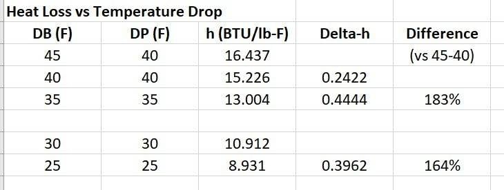

Here's some values for energy required to lower the temperature of air, in 3 scenarios: all vapor, condensing water, and frost:
It may be surprising that the heat loss per degree of temperature drop is lower for frost than for dew, but this is because there is less moisture in the air at lower temperatures/dew points.
I could see a rabbit-hole of more and more complex models of this...
