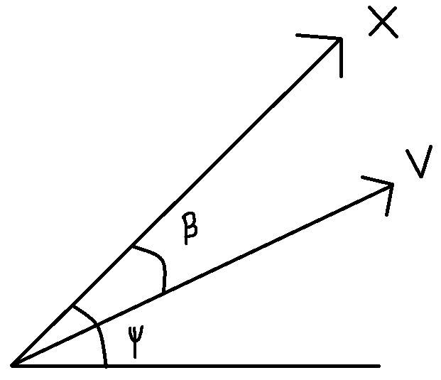

β is vehicle sideslip (angle between velocity and vehicle forward vector) ψ the angle between the trajectory tangent and vehicle forward vector. I have this equation that says
Vx * k * (cos ψ - tan β * sin ψ)
where k is trajectory curvature (1 / r) at point p.
Now i must say that I'm not proficient with compound angles at all, so I'm struggling to understand if everything inside the parenthesis is basically a compound angle. Moreover I'm struggling to visualize its geometric meaning.
Can anyone try to help me out with this one?
(I believe that k just acts as a multiplier according to the curvature so it's not the problem itself)
Thanks in advance
That's not an equation that says anything because there are no two sides with an "equals" sign between them. Setting that aside, you can rewrite the expression as
$$V_xk\frac{\cos (\psi+\beta)}{\cos \beta}$$
Does this answer your question?
