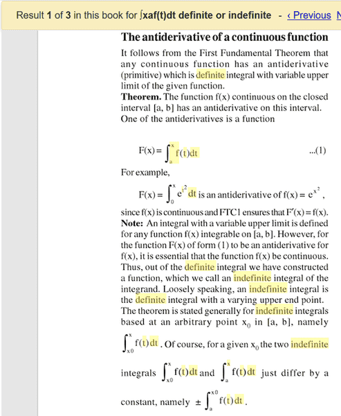

[tex]F(x) = \int_a^x f(t) dt[/tex]
I have found various arguments online for both.
Personally I think it's an indefinite integral because:
1) Its upper limit is a variable and not a constant, meaning the value of the integral actually varies with x. This is no different to the family of primitives represented by the indefinite integral, which also varies with x. [tex]\int f(x) dx[/tex]
2) If F is actually a definite integral then its value must be a constant, which in turn means its derivative must be zero, yet the derivative of F(x) is actually f(x) according to the Fundamental Theorem of Calculus.
Also, I found this but I think it brought more confusion than clarity.
It's a definite integral with a variable upper limit.
I agree with @PeroK that it is a definite integral whose upper limit is a variable.
I believe the definition of an indefinite integral excludes the presence of integration limits (be they given and constant numerical values, of functions), therefore it follows that the mathematical object in the RHS of the first line of the original post above must be a definite integral.

I disagree with the scanned text. F is "antiderivative of f" but not an "indefinite integral". The latter should be reserved for ##\int f(t) \, dt## which is an operator from a function to an equivalence class of function. See this.
What would you call the LHS of the first line then? According to the scanned text (in the spoiler), it calls the LHS function "an indefinite integral of the integrand [on the RHS]". Do you agree with this?
Because succinctly put, that quote basically says "The definite integral ##\int_a^x f(t) dt## with a varying upper limit defines a function which is an indefinite integral", which is kind of ridiculous.
I was going to argue that since you're calculating the area under ##f## over the interval ##[a,x]##, regardless of which ##x## chosen (as long as it's a real number), the result is going to be a numerical value, which when differentiated always gives zero. Yet FTC states the derivative of ##\int_a^x f(t) dt## is ##f(x)##, which is certainly not zero.
But then I read this. So it would appear that despite being a definite integral, as you claim, the derivative (w.r.t to ##x##) of ##\int_a^x f(t) dt## is actually not zero by virtue of the fact that ##x## exists in its upper limit. But to be fully honest, I still can't get my head around what is wrong with my argument above!
The link you provided seems beyond my scope. But I noted that the 8th line of the scanned text says "ONE of the antiderivatives is...", which is why I said it brought more confusion than clarity.
As was pointed out in post #6, an indefinite integral is an equivalence class of functions (differing by a constant). What you have is a straight function of ##x## generated by evaluating a definite integral with a variable upper limit.
Yeah, in this respect I'm now convinced that ##\int_a^x f(t) dt## is a definite integral.
The definite integral ##\int_a^x f(t) dt## = ##F(x)##, a single function- a particularly useful antiderivative of ##f(x)##.
The indefinite integral##\int f(x) dx## = ##F(x)+C##, a class of functions- the family of all antiderivatives of ##f(x)##.
Is that correct?
Is that correct?
Yes, exactly.
