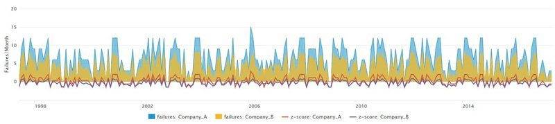

I'm not clear on what data you have and don't have, can you provide an example of the raw data you have for some of these events?
I can't speak much to the math, but here's how I would present the data if I had the number of failures for each company by month. The timechart uses the attached file 'failures.txt' containing randomly generated failures by month (500 for Company A and 1000 for Company B), and was created by the machine data analytics tool called Splunk.
Note 1: The failures for Company A are weighted x3 compared to Company B.
Note 2: The obvious correlation between the two companies has to do with generating the example data from the same RAND() column.
  • failures.txt
  • search.txt
Thank you @stoomart , this is very interesting.
I don't actually have data, this is a theoretical problem (for now). Your approach of generating simulated data can be useful to study this more pragmatically.
My question is how to make a judgment on the quality of prosthesis A compared to B (e.g. an estimate of what percentage of prostheses of each brand is defective), based on the recorded failures and on the number of prostheses that are 'active' in patients at each time, and the propensity of failure (e.g. the rate of failure per period per implant).
In fact, as the number of failures is quite constant on average in your data, I would expect this to be a situation where their number is also more or less constant. In my example I was thinking more of a case where the number of 'active' prostheses would increase over time, not necessarily linearly, and then I would expect the number of failures to increase with time.
