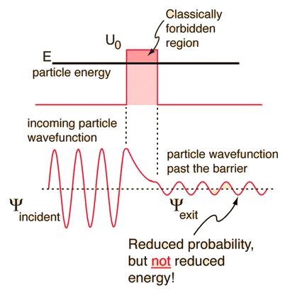

This image might help.
http://hyperphysics.phy-astr.gsu.edu/hbase/quantum/barr.html
