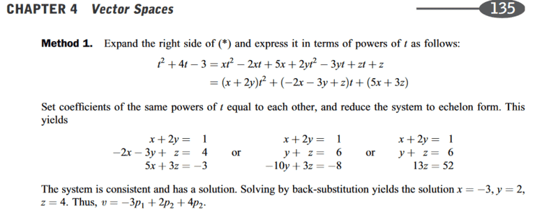

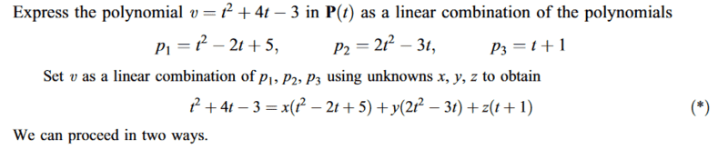

The question is asking to express a polynomial in terms of 3 other given polynomials, which in this case should be very straight forward but i am having issues, with the end terms on the second line they have grouped the constants that have a t^0. They have put 5x+3z, my answer says 5x+z, because they're the only terms with t^0 attached. Every other part of the answer matches mine apart from that one term, which ultimately changes the whole final answer. what am I missing?
The solution presented uses 3z, so I would assume that there is a 3 missing in the last term of the first equality.

TL;DR Summary: i cannot figure out where the 3z comes from

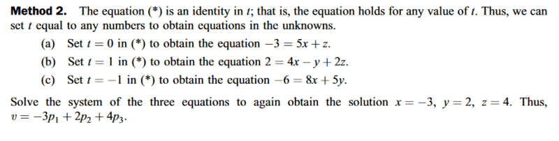

i will add that they used a second method which acknowledges the fact that there is no 3z, yet it has the same solution as using 3z, very confused
But where would that come from, this is the question and i cannot see anywhere where that term comes from, i have also posted their second method that doesn't use the term 3z yet has the same solution
You can check that setting ##x=-3## and ##z=4## doesn't solve ##-3 = 5x+z##.
Then the book needs to be revised.
