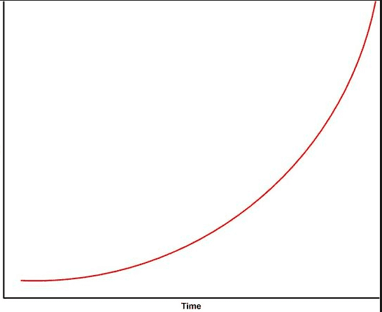

I have recently come across some data that is supposed to be random, but I don't think it is. I graphed it out and it sure doesn't look random. I also ran a couple of statistical tests such as the runs test, and they all say "not random." Visually, the data looks like a piece of a complex waveform (I've done a lot of work with sound synthesis, and the data looks like something I'd see in the window of an FM synthesizer). If the data in question is not random, it is really very important. If the data is forming a complex waveform, the implications are profound. I am not revealing what the data is, right now, because anyone who knows what it is will say "impossible," and their brains will turn off. I will tell you this about the data: It consists of 74 numbers only. Each number is supposed to be the sum of an extremely large number of random, independent factors. A reasonable metaphor would be, imagine you have a million dice. Imagine you - or something - rolls them all, every second, for the entire day, and sums up the results of all them. Imagine doing that for 74 days. That's what this data is like. I think data like that should obey the central limit theorem and be normally distributed. This data is not - not even close. And when you graph it out, this is what it looks like:
I'd really like to know if people agree with me that this data is not random, and if they agree it looks like part of a waveform. Of course it doesn't have to be both. The not randomness of it is more obvious when you focus in on one period at a time. For instance, look at days 46 to 63, below. See how the first half (days 46 to 54) is a mirror image of the second half (days 54 to 63):
Would that happen randomly? Now look at days 34 to 45.
See how it makes two slanted S shapes? And finally, check out the first 34 days:
That sure doesn't look like it's going up at a random rate. It looks like a steady, smooth curve. And the whole thing comes real close to a simple sine wave:
Please let me know what you think. After a few people have responded, I'll reveal what the data is, and everybody will say "holy @#&*" Thanks :)
Or you could just reveal the data and not try to play us.
Perhaps it would help us give you an answer.
I'm not trying to play anybody. If you don't want to help me, don't.

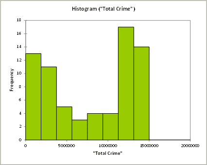

The data in question is the total number of crimes committed per year in the US from 1938 to 2011. This data should appear random. Crime rates are supposed to be the results of a large number of independent, random factors. Supposedly, this is the reason nobody can ever predict or explain crime rates. This by itself should make the data appear random. When you take into account the fact that there are literally hundreds of millions of people in the U.S., each one deciding independently of each other whether or not to commit a crime, if there is even just a little bit of randomness in the decision-making process for each individual, the yearly total should be like rolling 300 million dice over and over, all year, and then adding it up. If there ever was data that should be normally distributed, it's total crimes per year. But it isn't. Here's a histogram I whipped up:
That's not a histogram of a process with a lot of randomness in it. If something is the result of a large number of independent factors, the average result should be typical. It should occur frequently. You can see above that with total crime, the average results are very rare, and the extreme highs and lows are far more common. This is a histogram of something that is swinging, like a pendulum, which brings me to my next point. If there is harmonic motion in the crime data, which there would have to be if it formed a complex waveform, the implications would be profound. It would mean there is a fundamental frequency. All complex waveforms have a fundamental frequency. In this case it would be a fundamental frequency of crime, or, as I prefer to call it, a fundamental frequency of evil. There would also have to be a "restorative force." All harmonic motion requires a restorative force that resists and opposes disturbances, restoring the medium to its preferred state. In this case the restorative force would be resisting and opposing evil - a force that permeates the universe (or, at least, permeates the USA) resisting and opposing evil.
Stop laughing! Even if it isn't a waveform, the lack of randomness is important. By the way, the individual crime categories, murder, theft, rape, etc., don't show the same kind of symmetries seen in the totals, except for the years around 1991/2. Check out murders per year:

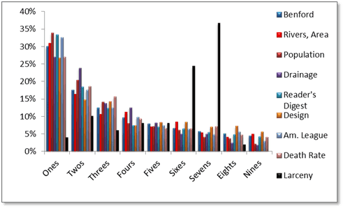

I've run the "runs" test on the totals and various subcategories, like, property crime rates in California, or rape rates in DC, (using this website: http://home.ubalt.edu/ntsbarsh/Business-stat/otherapplets/Randomness.htm) and the results are always "strong or very strong evidence against randomness."
For those of you that know what "Benford's Law" is, crime rates do not follow Benford's law. Here are some charts:
I won't try to explain Benford's law, except to say the lack of adherence to it suggests that something systematic is going on. Which I think is obvious from the graphs themselves. Like I said, whether or not the data forms a waveform, the lack of randomness is important. Crime appears to be a deterministic, dynamical system.

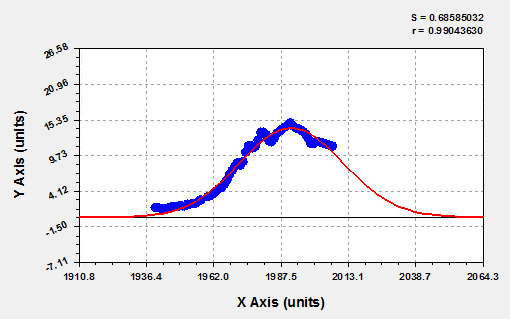

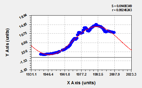

It is interesting that you mention gas pressure, and the exquisite accuracy with which it can be predicted. Below is a graphical representation of the vapor pressure model.
The equation that so accurately predicts vapor pressure, and which created that red line is: y=exp(a+b/x+cln(x)), where a = 8.77727455314E+004, b =-2.03300596916E+007, and c = -1.02099944799E+004]
However, that is not vapor pressure data that you see plotted there. That's the crime data, sticking to that equation with a correlation coefficient over 0.99. Are you beginning to see my point? The crime data isn't slightly non-random. It isn't random at all. The randomness is miniscule. There is clearly a non-random, dynamical system in effect here.
Sure, there are lots of independent, random factors influencing criminal behavior, but their overall effect they have on the year to year changes seen in the total is nothing compared to the non-random factor that caused it to go from approximately 2 million crimes per year to almost 16 million crimes per year from 1938 to 1991, and then back down again.
By the way, I am not saying the total number of crimes is going to continue to follow the vapor pressure model. The crime data fits virtually any mathematical model that creates a curve. Here's the Gaussian model, for example:
And here's sinusoid:
Again I say, the crime rates appear to be, not random, but a dynamical system. There's no way of knowing what model actually mimics the processes that determine how many crimes are committed each year. Nevertheless, those processes are so regular and non-random, that the data has a .99 correlation coefficient with a sine wave. No random process is going to spend 70 years mimicking a sine wave.
