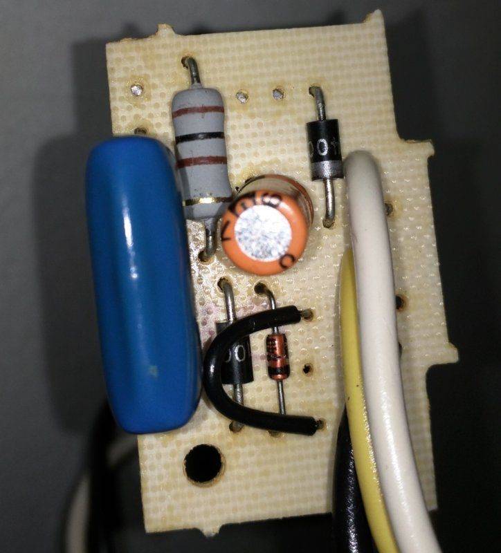

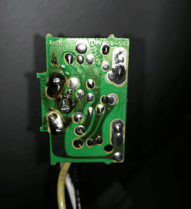

I found this circuit (attached images) in an insulated pouch inside my basement's smoke detector compartment. It gets power from the hot line that feeds my smoke detector, and outputs power to a mystery load through a second outgoing romex wire (no idea where it goes). All my smoke detectors work without this outgoing feed, so I removed it and left the second romex unconnected at the moment. Is this an AC/DC converter circuit or some kind of filter? The blue part has a eec1.OK Mer-S250V part number. What could this mystery device be doing? I was thinking security alarm related, the house has ADT hookup. thanks!
looks like the typical and nasty transformerless AC to DC power supply

Thanks. The wires soldered to this board are screwed onto the 14/2 and 14/3 romex cables, the 14/3 feeds the 120V to it and the smoke detector, and this board feeds the 14/2 romex whatever the transformed voltage is. The capacitor says 16V on it, so it probably outputs 16V DC? Is the blue part also a capacitor? I agree it's nasty and looks rigged by a previous homeowner rather than professionally done. Do you know why these are nasty as an AC-to-DC?
The orange part under the loop of black wire appears to say "240" on it. My best guess is that it is a 1N5240 which will make the output 10V. This is equivalent to D3 in the schematic that davenn posted.
You are relying on the integrity of the capacitor (C1) and resistor (R2) to isolate protect you from mains voltage. These types of supply are only allowed to be used where the output is permanently isolated from any external contact. If you do find out what this is for and want to keep using it then treat those wires outputting from the supply the same as you would treat the mains wires.

Thank you both, you confirmed what I suspected that it was an AC/DC converter circuit. I can't think of anything other than the security alarm system where this DC voltage would be needed on a permanently (and dangerously) connected basis (hidden inside a smoke detector compartment too!)... I think I will just keep it removed.
