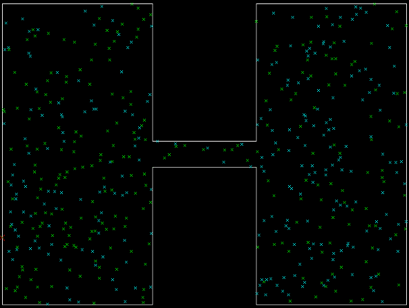

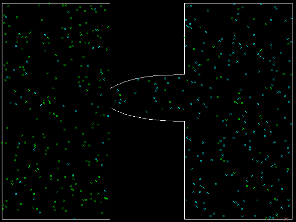

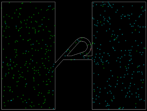

A though experiment:
We have two gas chambers at the same temperature and pressure, separated by a wall punctuated by very small pores. Let's say small enough to allow the pass of only a few gas molecules at a time (so, no complex interactions between gas molecules inside the pore).
These pores are designed to allow molecules passing from one chamber to the other easy, and hard or very hard in reverse.
This design (for the pore) comes to mind:
Non-imaging optics CEC
Another one could be a version of a Tesla valve, although I am not so sure of it's validity for single molecules.
The question is: would pressure/temperature in both chambers remain stable, or would the gas slowly migrate to the "easy pass" chamber, raising it's pressure?
If the second option happens, the systems seems to me akin to the Maxwell demon, as it violates the second law.
Such a system would allow to extract mechanical energy from the gases without a cold reservoir, until it's kinetic energy is exhausted, so I guess it's impossible.
Where is the catch?
All that matters is the size of the hole between chambers. Any baffling you put in the chambers is irrelevant.
Yep, that was correct.
I simulated a gas and different connections between chambers and eventually the gas density always equilibrates...

Simple passage
Using a CEC
Using a Tesla valve
...didn't see any noticeable difference in any scenario.

I was trying to answer the question about if it's possible to build a Maxwell demon only using non-moving parts. A kind of diode device that allows particles to pass on on direction but not in the other, without having any information about such particles (unlike Maxwell's demon).
The only check valve I know using only non-moving parts is the Tesla valve (which is being used in microfluidics). I don't think it's magic, but I was obviously misunderstanding its working principles.
I guess a Tesla valve acts as a diode only with a coherent and dense stream of particles.
