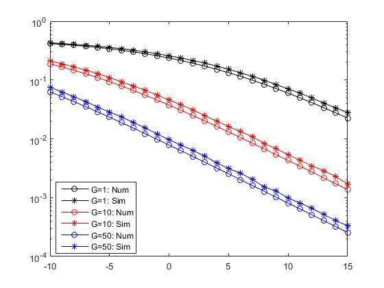

OK, now the integral is integrable, and Mathematica gives no complains. But when I compared the numerical results with Monte-Carlo simulations, where I generated ##10^5## samples for each point, I got very close but exactly the same curves. See attached Figure. My original equation is ##\varepsilon(\alpha_1,\alpha_2\alpha_3)=0.5\exp\left(-\frac{\frac{\alpha_1}{\alpha_2}G\gamma_Q}{\frac{1}{G}\alpha_3\gamma_p+1}\right)##. So,
[tex]\varepsilon=0.5-0.5\frac{G^2\gamma_Q}{\gamma_p}\int_0^{\infty}x^{-1}\exp\left[\frac{G\left(x+G\gamma_Q\right)}{x\gamma_p}-x\right]E_1\left[(\frac{G\left(x+G\gamma_Q\right)}{x\gamma_p}\right]\,dx[/tex]

I did Monte-Carlo simulations as follows
  1. For each ##\gamma_Q## generate three exponential random variables ##\alpha_i## for i=1,2,3.
  2. Find the value of ##\varepsilon(\alpha_1,\alpha_2\alpha_3,\gamma_Q)=\varepsilon(\alpha_1,\alpha_2\alpha_3,\gamma_Q)+0.5\exp\left(-\frac{\frac{\alpha_1}{\alpha_2}G\gamma_Q}{\frac{1}{G}\alpha_3\gamma_p+1}\right)##, where the initial value of ##\varepsilon(\alpha_1,\alpha_2\alpha_3,\gamma_Q)## is zero.
  3. Repeat for ##N=10^5## iterations.
  4. Find the average value as ##\varepsilon(\gamma_Q)=\varepsilon(\alpha_1,\alpha_2\alpha_3,\gamma_Q)/N##
Is there something wrong that gives me the difference between the two curves?
