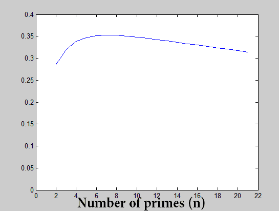

So I've used your approach empirically (that is, divide all lines by all primes in the set) and I have moved the "1" that resulted to the left side of the equation so we have:
1 > 1/P1 + 1/P2 + 1/P3 ...
- 2/(P1P2) - 2/(P1P3) ...
+ 2/(P1P2P3) ...
- 2/(P1P2P3P4) ...
and I just wanted to show you the results empirically, for the first 21 primes. It seems like it will never reach 1 unless something surprising happens. So the question is whether we can prove that it's converging below one, or that it is not converging but that it is constantly decreasing and never going back toward 1. The Y axis shows the sum of the right hand side of the inequality.
I'm attaching here the Matlab code used to generate the previous figure in case someone wants to reproduce the empirical algorithm. It's currently going very slow because I use the function nchoosek, there is probably much faster available.

Where does the new expression come from?
If you stop after 4 elements, it will go to negative infinity. If you always consider all those terms up to n as the code suggests, the question becomes more interesting.
Likes JFGariepy
Definitely, the illustration of the case of 4 is simply because I have a hard time expressing it in general terms but yes, the system grows with n and I certainly do not limit the question to 4 lines. The question I ask is whether or not SumsData(i) will remain below 1 at all times as i goes to infinity. And a cleaner, more general representation of the inequality would be:
1 > 1/P1 + 1/P2 ... + 1/Pn
- 2/(P1P2) - 2/(P1P3) ... - 2/(Pn-1Pn)
- 2/(P1P2...Pn-1Pn)
(note that for odd number of lines the line finishes with a - whereas for even number of lines it would finish with a +)
This formulation of the problem comes from the actual problem as I am facing it. This is a missing piece of the puzzle in imposing a boundary on prime densities of certain types of primes for me which is needed as part of an on-going attempt to prove the Goldbach conjecture.
