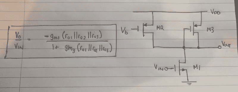

All MOSFETs (no JFETs)
Ignore body effect.
Is my gain correct? Just want to confirm.
It is a bit difficult to tell without relevant equations.
The sign is probably correct.
What are r01, r02, r03 ? Channel resistance?
What does || mean in your shorthand?
Where is gm2. Is it = GM3 ?
