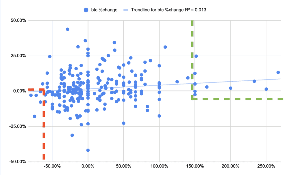

Can statistical significance be established if the low Y outliers tend to be associated with low X values and the high Y outliers tend to be associated with high X values?

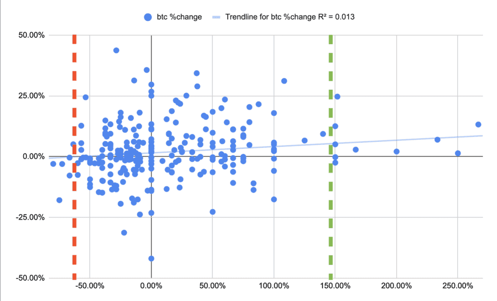

X-axis = past 1-week percent change of the search term "best bitcoin wallet"
Y-axis = future 1-week percent change of the price of bitcoin
From the data, if the number of searches increases by more than 150%, it seems the price of bitcoin almost always increases, however, there are only 10 samples out of 260 of this happening. Likewise, if the number of searches decreases by more than 60%, bitcoin almost always drops.
Could this be statistically significant? Any comments on this?
FactChecker said:
No. The X-axis parameter explains very little of the Y-variable parameter variation. An ##R^2## value of 0.013 indicates that there is very little statistical significance in the linear regression. (See https://statisticsbyjim.com/regression/interpret-r-squared-regression/ )
I understand that the data as a whole has little to no correlation, but my hypothesis is that during extreme events, X might be predictive of Y. Is there any way to prove/disprove this hypothesis?
I've plotted the distribution of X and found that it follows a log-normal distribution. My idea is to exclude values n standard deviations away from the mean and plot the graph of n vs the R-squared value. If the R-squared value increases as I increase n, will this indicate that my hypothesis is correct?

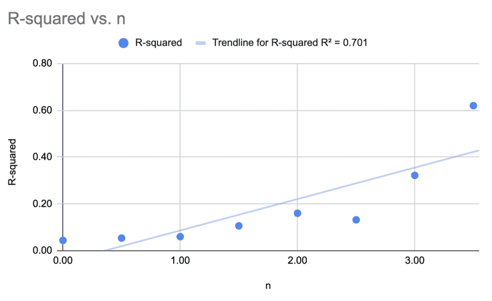

I went ahead and did it. Got a pretty decent correlation and an R-squared of 0.701.
Vanadium 50 said:
A good statistical rule of thumb: if you have to ask, the answer is "no".
My personal view is that if you a posteriori throw away 96% of your data, you don't have much there there.
I've used all the data with my method but not sure if that's indicative of anything. Are there any other ways to prove/disprove this hypothesis?

So your question is: If the low Y outliers tend to be associated with low X values and the high Y outliers tend to be associated with high X values, can a statistical significance be established. Good question. It doesn't seem unreasonable to me. But I do not see that tendency in the data in your original post.
Is there a way to mathematically prove this? Here is what I see (but we all see patterns even from randomness):
What happens if you change your lower threshold to 50%, or your upper threshold to 100%, or both? What happens if you take the first half of your data, choose thresholds based on that, and then apply those thresholds in the last half?
I've already tried incrementally increasing/decreasing both lower and upper threshold by 0.5 standard deviations starting from the mean, calculated the R-squared value, and plotted the results as seen in post #6 and #8.

I see that now. It isn't very convincing in my opinion. You have to toss a lot of data before you get a decent regression.
A better approach would be to take the first half of the data, choose a threshold based on that, then see how it performs on the last half

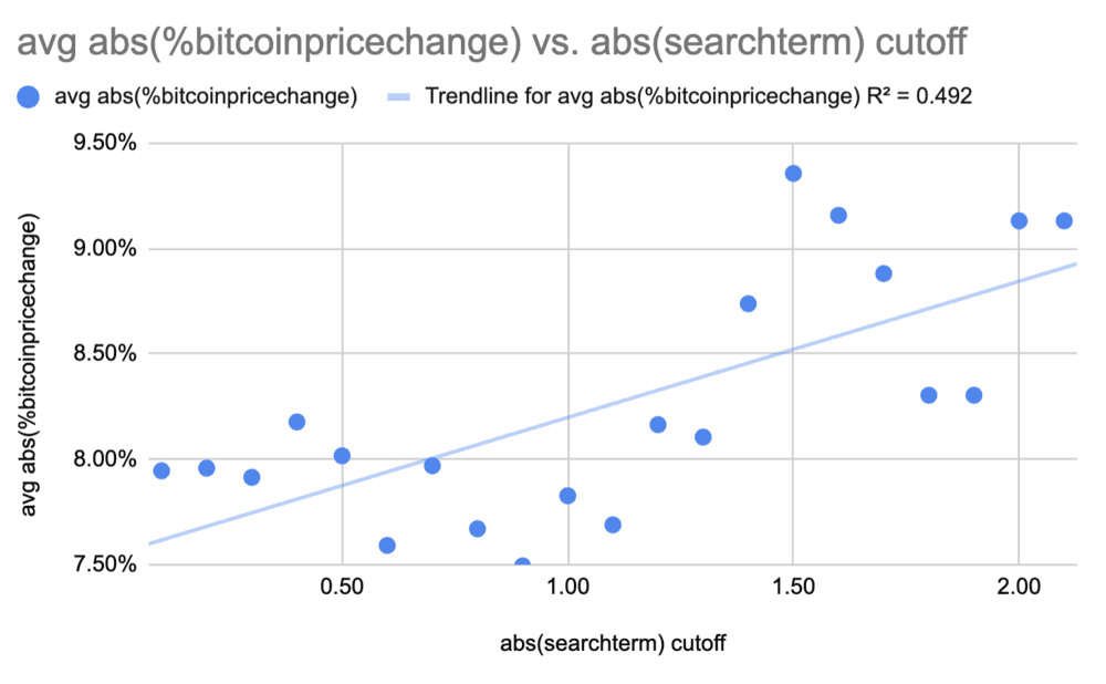

A logistic regression that only triggers with a significant change in search might help, or simply using a probit where, x=1 if abs(search activity) >X%, zero otherwise. Be careful that you lose a lot of data the more you cut off x
Got a pretty decent linear correlation using your suggestion. Any thoughts on this?

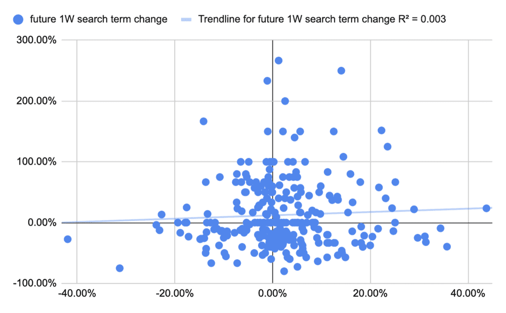

BWV said:
also reversing the variables would be interesting - does last weeks BTC performance correlate to internet search activity this week?
Adding an autocorrelation variable (i.e. last week's BTC return) might be interesting as well
Seems to have zero correlation to me. X-axis = 1W bitcoin price change, Y-axis = future 1W search term change
