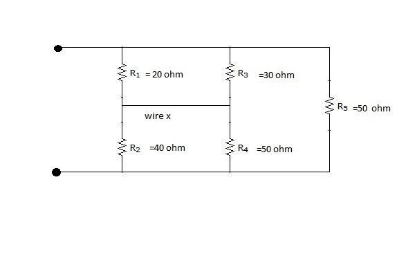

find R equivalent of the circuit
i tried the following but not sure
R1 R3 parallel
R2 R4 parallel
then both results above as series
and at last the result from above as parallel with R5
please correct me if i am wrong
R1 R3 parallel
R2 R4 parallel
You're right.
