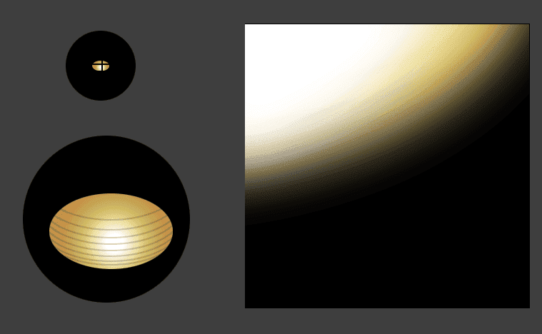

Bought this item online. Does not give me an image. Don't know if it's me or if it's defective.
Looking for input on whether I've bought a lemon or if I just need some finesse.
For a lark, I bought this 1.25" eyepiece compatible webcam for my scope. I had low expectations but knew I could only find out by trying it.
https://www.amazon.com/gp/product/B08DP1YZP8/?tag=pfamazon01-20
First thing I notice is that there is no lens. I could reach in the pupil and touch the PCB.
I have no idea if that's normal or if I got a defective product.
I hooked it up to my computer (with a generic webcam driver I found online called Oasis.exe) and tried it out inside. It can detect light and dark (if I move it around), but is so far out of focus that I couldn't see a black barn in a snow field. It sure seems like it is missing a lens.
I tried it out on my 6" Newt and it's really little better.
I pointed it at a nearby streetlight to calibrate. In the diagram, you can see the streetlight in my finder (OK), in my 32mm eyepiece (OK) and in the webcam (not OK).
The webcam image is huge (at least, within the small 480x640 frame) but is so out of focus that it can't resolve anything. (I don't think *this* is because the streetlight is too close.) Also, the light is WAY blown out.
So I pointed it at a less bright subject (a lit window across the street) and could see nothing - completely black (with noise).
This makes little sense. It's blown out when pointed at a streetlamp but not sensitive enough to pick up a lit window - let alone Mars or a star.
And I don't understand why it's out of focus so badly. *Should* there be a lens in there?

With no lens, the imaging sensor should be placed at the focus of your telescope. This may or may not be possible depending on your scope. I would use an eyepiece and focus your scope on a distant target during the daytime and then replace your eyepiece with the imager. Move the focuser all the way in and then slowly bring it back out and see if your image gets better or worse.

No, there shouldn't be a lens in there ... none of the astro-cameras have lenses
As Drakkith has said, this will be purely a focussing issue.
It's just necessary to experiment and find where that focussing point is.
It may be further out than an eyepiece or further in
It may be WAY further out and you need a short extension tube

You can try to find the focal plane of the telescope with a sheet of paper. Aim at the streetlight with the focuser racked all the way in. Hold a sheet of paper over the eyepiece opening and move it back until the streetlight is in focus. That is the focal plane and the camera’s sensor needs to be right there. Might help to determine the right length of extension tube you need.

I disagree that the camera focus should be further out than the eye piece focus. It will be further in and many Newton scopes (especially smaller ones) can't reach camera focus because often their focuser is optimised for visual use.

Caveat first: @glappkaeft may be right that it is in-focus that is needed. If that's the issue, then it may not be solvable.
They don't - they need extension tubes (or more in-focus) for imaging. But whereas the manufacturer of your telescope knew you'd be using it for visual/with eyepieces, they didn't know you'd be taking pictures with it. Especially if it is an older or lower-end scope.
Newtonians are less forgiving than other types of scopes. For a refractor, they can just make the main telescope tube shorter, then add extension tubes on the back.
So, if standard eyepieces work with all scopes, that would imply a standard extension tube should put a webcam within the scope's travel, regardless of the specifics of the scope.
There's no "standard" for eyepieces. Here's a thread on another site discussing it, including a list of eyepieces a guy tested, with a total of 35mm difference in focus location:
https://www.cloudynights.com/topic/310666-master-eyepiece-focus-distance-chart/#entry3990093
A telescope manufacturer will know for sure that the eyepieces included in the kit will work. But different eyepieces have different focus points. And then adding a barlow or focal reducer changes it again. And cameras are different too. And then when you get seriously into astrophotography, you'll add a filter wheel... and maybe an off-axis guider...

When debugging this issue, I suggest trying to focus on some distant, terrestrial target in the daytime. Try a distant treetop or a telephone pole. (Do not use the Sun, or anything near it, as the target.)
Once you have things set up and roughly pointed at the target (as best you can), adjust the camera gain and shutter speed (in whatever software program you are using to control the camera) such that image on the screen is brighter than completely black, yet darker than completely white.
The point of the above is to rule out problems with exposure. It could be that one of the reasons you weren't able to see anything is the exposure was too short. Adjusting the exposure for daytime, terrestrial objects is way, way easier than trying to get that figured out with celestial objects. (Of course you'll have to re-adjust that later for each and every celestial object; it's just way easier to do in the daytime, for preliminary focus debug.)
Once the exposure is somewhere in-between black and white, try to get the object in focus. (Now would be a good time to double check that the scope is pointed at an actual object and not an empty patch of sky.) Even if you can't achieve focus, you should at least be able to tell if the object's focus gets slightly better or slightly worse as you adjust focus.
If the ideal focus is farther out, you might be able to achieve focus by pulling the camera out of the eyepiece holder a little bit, and re-tightening the thumbscrew with the camera a little "out."
If the ideal focus is farther in, as in closer to being inside the telescope tube, things get more complicated. In that case, as previously mentioned, it might be possible to achieve focus raising up the primary mirror by adjusting all 3 collimation screws in the same direction, or by getting a lower-profile focuser.
As Russ and Drakkith mentioned, when focusing on infinity, you'll need a smidge more inward focus than you'll have when focusing on a terrestrial object. But this daytime procedure should at least get you in the ballpark.
