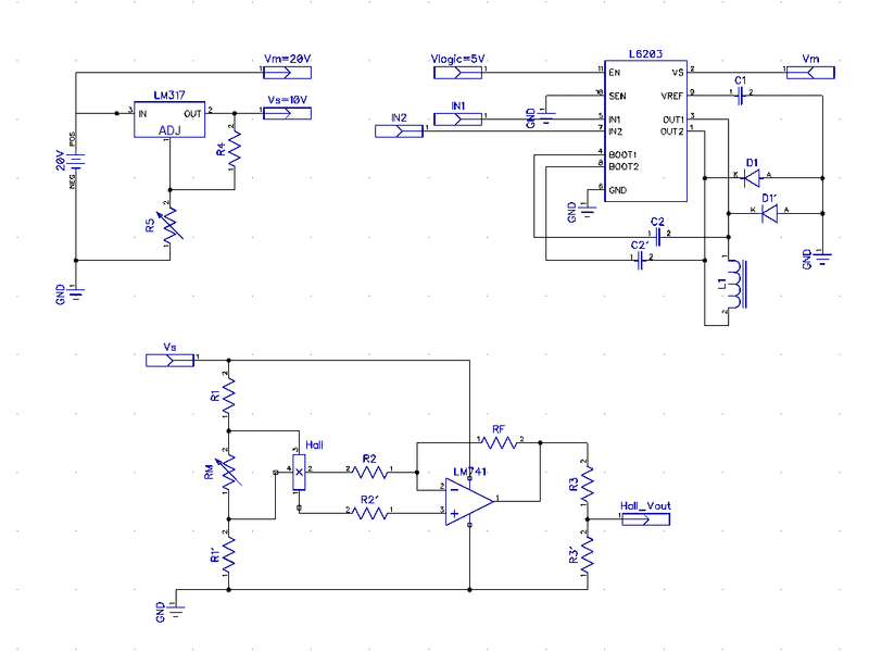

Can you post your circuit schematic so far? There are several ways to do this...
Hi!
That's about what I have on the bread board:
(It's for an exercise I want to do, a megnetic levitator, just to learn more about electromagnets, and how to control them... It already almost works. Still need to tune the PID controller program more.

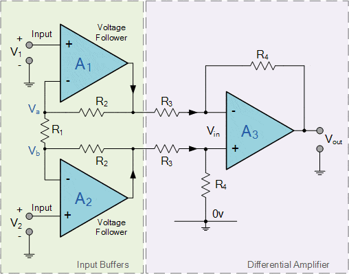

We really need more info on the Hall sensor IC to be of good help. In EE, we don't just do things by trial and error -- we use the datasheet to tell us the best ways to use components, and to understand what we have to take into consideration when using the component in ways different from the traditional way they are used.
Since you say it appears to be similar to other Hall sensors, can you find an example sensor and point us to the datasheet? That would be a big help.
I'm not a fan of using voltage dividers to make virtual grounds for single-supply applications with opamps. There are generally better ways to do this. But without seeing more info on how the Hall sensor is traditionally hooked up, it's hard to just "guess" at a good solution. Hope that makes sense. :-)

what are you using to digitize Vout? What does the ADC input to your PID controller look like?
It's the ATmega/Arduino ADC, read the scaled down output of the LM741 to 5V by another volage divider (R3/R3'). Since the LM741 isn't rail to rail, I need to clamp the read values on the microcontroller to the range the PID program can use.
That's the circuit on my bread board (Arduino using only the Hall_Vout input, and the IN1 output to control the magnet by PWM).
(The PID program works okay, adjusting the PWM signal to power the coil. But I ran into almost unsolvable instability issues... Almost giving up on this small levitator project... It's quite hard to tune all the parts (software/hardware). I don't yet know what which parameters cause the instability...)

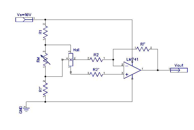

Is it a good practice make a virtual ground with such a 3-resistor voltage divider? When driving a differential opamp with a single power supply (direct coupled, I need to amplify the actual input value, and not only changes in input voltages...)?
berkeman said:
Yeah, that's what I was thinking. The bias current should just come from some current source between the rails, and one side of the sensing terminals should just be tied to a Vref (like 2.5V), so that the delta-V from the Hall effect generates a positive offset output voltage out of the opamp with respect to that Vref...
I was thinking something along those lines too.
The hall sensor has 2 output pins, and their difference should be amplified... as far as I've understood. So there is no constant Vref.
@Current source betweent the rails:
The voltage measured over that RM pot was set to about 1.2 V, without the sensor hooked up, measuring the voltage with a multimeter. So that the resistance/voltage drop over the hall sensor, which is then wired in parallel to the pot, doesn't reduce the voltage too much later on, so that it stays over 1 V, which is required minimum (found experimentally, kept it low to not damage the sensor, it could be probably higher...). Instead of using that pot, the same can be done with that formula from the first post...
That's only needed because I use a single power supply. The output of the hall effect sensor moves up/down from half it's supply voltage (1V / 2 + virtual ground). And the difference of the two output pins should be about zero without any magnetic field applied. So it lies right in between the rails (Vs <-> Gnd).
The output signals from both output pins is then fed into the differential OpAmp (LM741) which amplifies their difference by a gain of RF/R2 (?)... (which can be tuned by hand, RF is actually also a potentiometer in the circuit).
As far as I figured it out so far, the OpAmp "calculates" their difference and amplifies it. Taking the non-invenrting input (+) subtracting the inverting one (-). Both are/should be in the middle of Vs (10V / 2) at the beginning, so that that the output of the opamp can swing in both directions. - It adjusts the output voltage, so that it gets as close as possible to the non-inverting input voltage (which also can be moving in respect tho other one), over the feedback resistor RF.
The voltage swing of the outputs hall effect sensor should now be amplified up to the range of Vs=10 V to Gnd (with some margins). (The LM741 needs at least 9V to operate, as far as I've read...)
I don't know if that all makes any sense...
berkeman said:
Or it could also have a diffamp inside the IC with a differential output, like this HAL1 IC from micronas:
http://www.google.com/url?sa=t&rct=...ysRqxelOrzui87LPYyfk7Ag&bvm=bv.83339334,d.cGU

1rel said:
It's wired much like in the image above, just with "offset" in voltage, i
i don't know what that means. Offset?
it's okay so long as you don't demand it supply any current (any that is beyond opamp input bias current, usually less than a microamp)
looks to me like you've violated that.
R2' can have no current
but R2 assuredly does.
If you draw inside your hall IC a four terminal wheatstone resistor bridge
it allows current to flow between terminals 2,3 and 4
meaning,,,
opamp's output can change voltage at its noninverting input
because making opamp output more positive reduces current through R2 which reduces drop across R1
which makes volts at hall sensor more positive,
increasing voltage at R2' and opamp's noninverting input
and that's positive feedback
which gives stability problems
which you list as a symptom.

That sounds really interesting! But I don't understand yet what you're saying there...
Bias current of an opamp means: the current that actually flows into the opamp input pin? For an ideal opamp that would be zero?
If that is in reality always never ideal, I need to allow current flow into the inverting input of the opamp?
I'm just started to learn about using opamps, so it's very likely that something is wrong with the circuit above... that's why I asked initially.For what I learned so far, it's okay to assume that there is no current flowing into the inputs of the opamp.
I also assume, that there's not much current flowing out of the hall sensor outputs.
So, looking at the schematic again, I also see problems there (so, wondering again, why it actually worked on the bread board, like that...)
There's no current flowing into non-inverting input of the opamp. It just senses the voltage on the output pin 1 of the sensor, as a reference (let's call it V+). Right?
Now if the voltage on the inverting input (V-) of the opamp, is for example, 10 mV higher than V+, what happens? - I thought, that the opamp now tries to change its output voltage, so that V- matches V+...
But it seems like, there can no current flow back through the feedback resistor RF... to make V- equal to V+ by changing the output voltage of the opamp.
Should I add a resistor from the non-inverting output to virtual ground? Maybe I try that later on...

What is voltage between pin 2 of Hall sensor and output of 741? That voltage willl cause current of V/(R2 + RF) to flow, and that current must come out of hall sensor pin2.

you could buffer both inputs to your difference amp with followers. see "instrumentation amp" here..
http://www.electronics-tutorials.ws/opamp/opamp_5.html
Your buffers neednt have gain, you could leave out R1.

@Instrumentation Amplifier:
Adding two more OpAmps, or a special more expensive IC with all the circuitry inside, for that simple sensor would be overkill I think. But to learn more about input buffers and more precise measurement, I'm going to try it as soon as I come back to it...
Currently learing about transistors, logic gates, flip flops... More low level things. - If I eventually get how buffers, current mirrors, current sources, totem pole push pull / open collector etc. circuits really work, things may hopefully become more obvious. Might be trying to make a simple opamp with transistors/discrete components only soon (and come back here with lots of questions) ;)
It looks fearsome at first.
But it's easier than it looks if you use a "quad" opamp
which is four opamps in one package.
I personally like the LM324 because it is wildly popular so available everywhere, and cheap.
Further it will work from a single supply.
