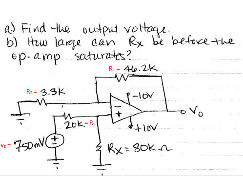

In summary, the problem involves finding the output voltage (vo) of a non-inverting op amp circuit with two input resistances (R1 and R2). The equation for vo is vs * ((R1+R2)/(R2)), where vs is the input voltage. The question is whether vo will be independent of another resistance, Rs. To solve the problem, the voltage at the positive input (vp) is first found and then used to create a "new" circuit for finding vo. The final output voltage is determined to be 9000 mV.
Inept
vo = G*vs
where G = ((R1+R2)/(R2)
therefore,
vo = vs * ((R1+R2)/(R2)
would vo be independent of Rs ?
I assumed it was a Non Inverting Op Amp...but I haven't come across one with (two?) input resistances? I'm not sure where to go with it. I began to use the equation I have above, but I don't think it's right. I think (or I keep telling myself) that I have to use Rs or Rx in part a somehow.
For part b) I believe I have to figure out the linear range of Rx, which should be doable. So I'm not worried about that, assuming what I'm thinking is correct...
If anyone can help thanks! If not, thanks anyways!
One question that may help - What is the voltage at the + input of the Op Amp. Is it 750 mV, or something else?

For starters, what is the voltage at the + input (in terms of Vs)?
EDIT: phyzguy had the same thought.
I solved it, I had to solve for a non-inverting (positive) input voltage (vp) first and then created a "new" circuit. Using that circuit I found the output voltage using that equation I listed above while replacing vs with vp . I got vp = [(80k/(80k+20k)]*750 mV = 600 mV
then vo = [(3.3k+46.2k)/3.3k]*600 mV = 9000 mVIt feels good to figure my own answer out...lolEDIT: I didnt refresh, so I didn't see your guys replies. Thanks all! :)
