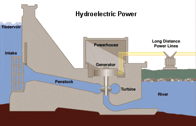

Andrew Mason said:
The better term would be "electro-motive pressure".
Something that people seem to forget in trying to hop freely between Potential and Force (water or electricity) is the fact that the Field (force on each charge) can be anything you want for a given PD. A long 1W resistor has entirely different Fields along its length from a short 1W resistor. The two resistors are electrically identical.
The relevant Potential Difference, in the case of the hydroelectric system above is all across the Turbine (we assume the pipes are all wide enough and no work is done in getting the water to the turbine input port). The Pressure on the turbine is more or less ρhg and the Force depends entirely on the design of the blades etc. etc. When you get down to it, the water model is at least as complicated as the electrical model because the Kinetic Energy of the moving water is also relevant. KE doesn't come into it when you are talking about Electrical Power.
I could go on further to demonstrate that the 'simplicity' of the Water Model is a snare and a delusion. The fact that there are so many Electrical Engineers who can operate at a reasonable level of competence yet very few Fluid Engineers who are as 'good' at the theoretical level, goes to prove my point.
It may be time, I think, for the Electrical Model to be used to 'explain' Water Flow problems. (But only the simple ones)
Likes frankin garcia
The pressure difference or potential difference is ##\rho g\Delta h## (potential energy / unit volume).
Kinetic energy is not really a factor in the water model either, except that there has to be some movement of the water through the turbine. The work done in passing through the turbine (assuming no change in kinetic energy through the system ie. steady flow rate with no difference between the size of the inlet and outlet pipe to/from the turbine) is pressure (difference) x volume or potential difference x volume.
AM
Likes Merlin3189 and frankin garcia
