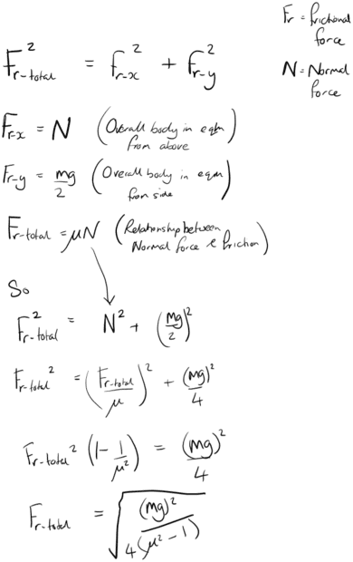

The question initially asks for minimum force, F first, so my calc's were thus:
(I'll use Fr for friction..)
Fr-total^2 = Fr-x^2 + Fr-y^2
substitute Fr-x = N and Fr-y = mg / 2
Fr-total^2 = N^2 + (mg/2)^2
subs Fr-total = μN
Fr-total^2 = (Fr-total / μ)^2 + (mg/2)^2
which simplifies to
Fr-total = sqrt( (mg)^2 / ( 4( μ^2 - 1 ) )I tried this as an answer and the reply was that this was the Normal force, not the frictional force.
(Just to see where this went, I then multiplied the answer above by μ and it told me this was the frictional force, which makes sense if I had calculated N and not Fr-total).
I have the answer to the total force on the body now F^2 = N^2 + Fr-total ^2
BUT, I don't understand where I went wrong in calculating N and not Fr-total...

Yes, that's what I started with - see below...
But the IsaacPhysics response tells me that I have just calculated the Normal force, not the total frictional force...
I can get to the correct answer for the total force on the body if I know why the above is the Normal force, not the total frictional force...
You did a simple algebra mistake $$1-\frac{1}{\mu^2}=\frac{\mu^2-1}{\mu^2}$$ hence at the very last step the correct expression for ##F_{r-total}## is $$\sqrt{\mu^2\frac{(mg)^2}{4(\mu^2-1)}}$$
Ah - now I feel dumb! ;-)
(I obviously missed the μ ^ 2 - trying to rush the simplification!)
Thank you, that all makes sense now.
The second part of the question is easy in terms of minimum μ - anything less than 1 gives imaginary roots.
