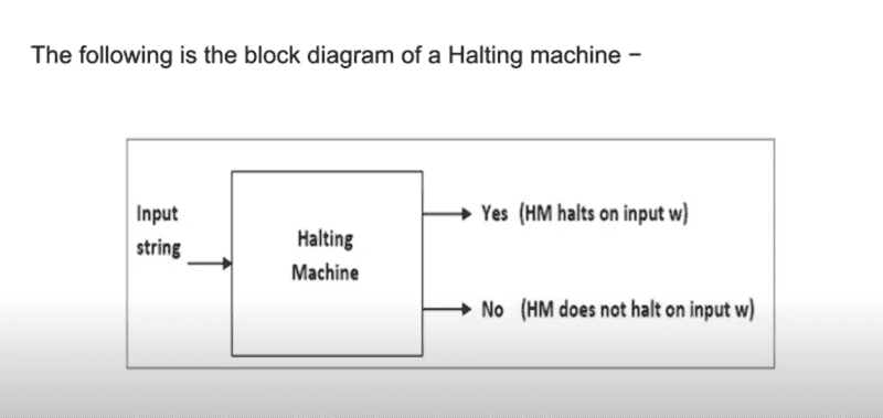

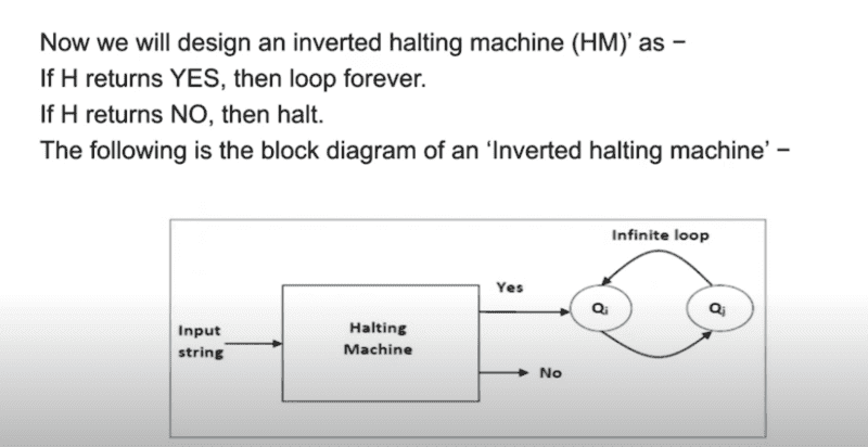

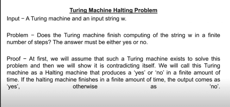

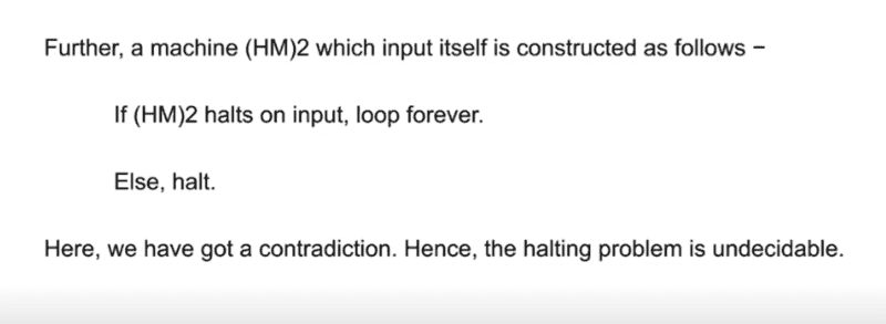

this video uses some short method to prove this
source-:
This proof seems simple to me, is this correct? (Asking as there are lots of spams in youtube these days, can't trust anything naively).
Have you compared the proofs to one another and to pbuk's version?
Likes pbuk
i didn't get it quite...maybe because my programming are bit rusty.
