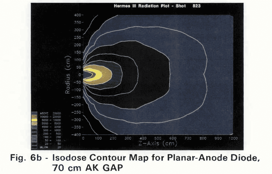

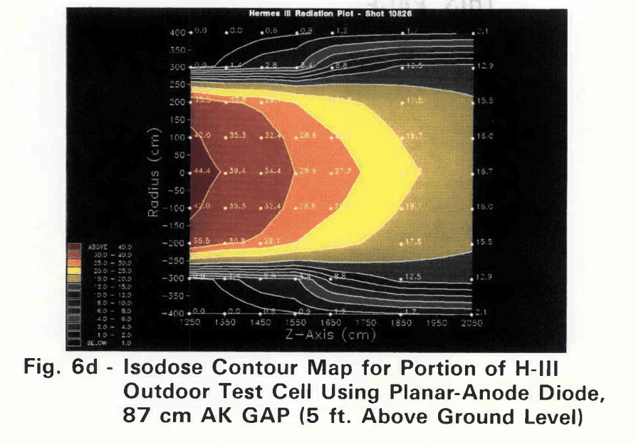

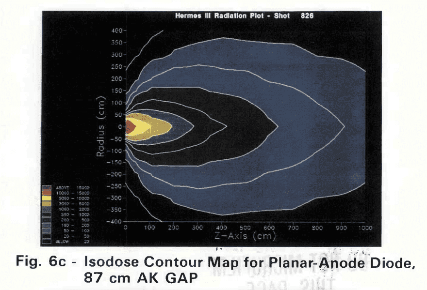

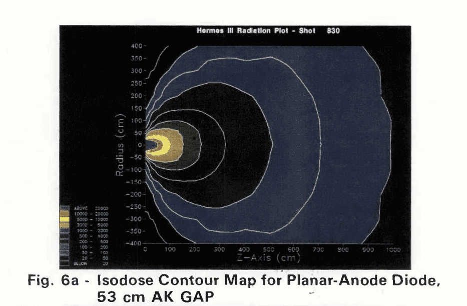

- How to interpret the isodose contours?
These pictures below show four isodose contours of HERMES III with different anode-cathode gaps. The radiation produced are gamma rays. More informations can be seen here in the article https://www.osti.gov/biblio/6233581...-simulation-technology-laboratory-guide-users
![HERMES III isodose contour map 1.PNG HERMES III isodose contour map 1.PNG](https://www.physicsforums.com/data/attachments/253/253292-d8aae586babb024ea01640921b639fa4.jpg)
![HERMES III isodose contour map 2.PNG HERMES III isodose contour map 2.PNG](https://www.physicsforums.com/data/attachments/253/253293-9a67fa9886546f833602aaefcff48b4b.jpg)
![HERMES III isodose contour map 3.PNG HERMES III isodose contour map 3.PNG](https://www.physicsforums.com/data/attachments/253/253294-e638abdb01cb1d6c1825fd179655bfae.jpg)
![HERMES III isodose contour map 4.PNG HERMES III isodose contour map 4.PNG](https://www.physicsforums.com/data/attachments/253/253295-61e01b5bbaef1996db3f94bc9f99f5c5.jpg)
According to the description which you can see somewhere in the article, it said "The series of maps in Fig. 6 illustrate isodose contours for AK gaps of 53, 70 and 87 cm both in the indoor cell and the outdoor cell. The patterns are symmetrical about an axis perpendicular to the center of the faceplate (defined as the z axis) and can be viewed as being in either a horizontal or vertical plane. The TLD data from which these maps were drawn, by a UNIRAS graphics software package, is stored in the STL VAX 11/780 and can be manipulated to illustrate the radiation contours in a variety of ways. For example, cross-sections at various z-axis locations, three-dimensional representations, and enlargements of any particular region can be generated. Representative illustrations of these possibilities are shown in the series of plots in Fig. 7."
My question is how do we interpret the isodose contours above? Is there anyone here who work with Sandia National Labs? If I have to interpret the pictures, judging by the Radius and Z-axis in cm, the gamma rays extend to 1000 cm which is equal to approximately 33 feet long and the radiation width is 800 cm which equal to 26 feet wide especially in the first three pictures. But I'm confused about the last picture, is the radius and z-axis correct? Compare to the previous three pictures, the gamma radiation at the last picture seems to be very huge and also seems to be zoomed in. English is not my first language so I'm sorry. Thoughts?
