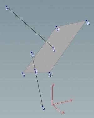

I've created two images that hopefully help illustrate the behavior: Ray at origin, ray offset from origin (along the y axis).
While preparing the images, I noticed that the intersection point (8) no longer moves in curved paths (as described in my original post). It now stays on the plane at all times, just increasingly far away from the ray as it is moved. I don't know what I changed to affect this (code looks the same), but I imagine it's closer to the solution.

Well, this is odd. Just plugging your numbers into a pocket calculator, and going through the lines of code one by one, I don't get the same values as you. For the first case, I get the intersection at (0, -0.1699742, 0.8338610) and for the second case it's at (0, -0.3158999, 0.6912280). There's a small discreoancy, even in the first case. What's more you can easily check that my values are exactly right by taking the dot product of (hit-p0) with (p1-p0) which comes out to be zero showing that the hit lies in the plane. Then take the dot product of (hit-l0) with (l1-l0) and divide by the norm of both vectors and that comes out to be exactly 1, showing that the hit lies on the ray.
I don't see how you obtained the values you did because if your code really was as shown above, then it would have to give the values I calculate. The only thing I can think of is that you've mis-transcribed one of the numbers (or I've mis-read them) and you have omitted the second correction that I made to your code. Did you notice I made two changes? (The last two lines.)

Ah I'm dumb, I had only seen the change in the last line and missed the first l1 - l0 subtraction in the assignment to t. That also explains why your code seemed more "off" to me than what I had before.
Now that both lines have this operation, the projection works correctly no matter how I offset the ray's origin. Thanks a lot for you help!
