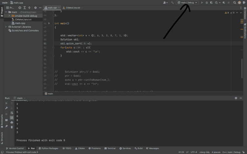

The compiler is not using C++11 or greater on CLion. My CMakeLists.txt reads:
cmake_minimum_required(VERSION 3.24)
project(main)
set(CMAKE_CXX_STANDARD 17)
add_executable(main main.cpp)
set (CMAKE_CXX_FLAGS "${CMAKE_CXX_FLAGS} -std=c++11")
Any idea what's happening? C++11 worked when I first created the project, but now that I closed it the compiler seems to not work. Any help is greatly appreciated. I'd provide more files if I knew what was relevant.
How do you know? Does your program use C++11 features that aren't present in whatever C++ standard that your compiler is actually using?
What does "C++11 worked" mean? Telling us that something didn't work doesn't give us much to go on. How do you know that C++11 isn't working now? E.g., compiler error/warning messages, runtime errors, program behavior.
Yes, as an immediate example, the line: std::vector<int> v = {2, 6, 5, 3, 8, 7, 1, 0};
gives the error:
error: non-aggregate type 'std::vector<int>' cannot be initialized with an initializer list
Also warnings with range-based for loops, etc.
This means I wasn't getting these errors until I restarted CLion. It doesn't work now from the errors above and the c++11 warnings, which would not occur if I was actually using c++11 or higher. All I do is press the green arrow to run the code from the CLion interface.
Given that support for makefiles is an experimental feature in CLion you need to do a bit more than that. In particular, unless you are very confident in all three of the following:
  1. using makefiles outside the CLion IDE (e.g. by running gcc from the command line);
  2. working with CLion to adjust settings and tools used in the compile path; and
  3. combining information from system documentation, error messages and other debugging techniques to work out what is going wrong and how to fix it,
I would say that you should either stop using makefiles and let CLion manage the build the way it is designed to or stop using CLion and use an IDE that is designed to work with makefiles.
Likes member 428835, Mark44 and Vanadium 50
Okay, I found the issue, which has a simple fix. It's detailed at CLion's website here. Attached is a screenshot for anyone who may struggle with this in the future: just change the run configs (see the arrow) from the .cpp file to the project. Very obvious now that I'm aware. Thanks for the help!

A black arrow against a nearly identical black background isn't the easiest thing to read...
Likes Vanadium 50
Yea couldn't figure out how to change it so i made i super thick. It stands out very clear to me though. I'd say the bigger issue is why the screenshot quality is so poor.
  1. Your screen shot includes the whole screen. Including just a portion of the screen would have been clearer.
  2. White characters against a black background is not as clear as black characters against a white background.
