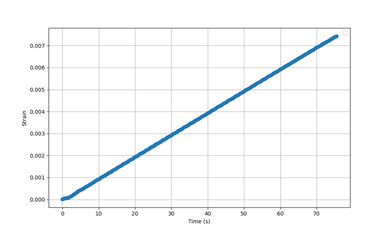

Hello everyone,
I'm currently working on comparing the viscoelastic properties of different materials, specifically rubber and foam, using results from compression tests performed under displacement control. My initial aim was to compare the energy dissipation characteristics of these materials using hysteresis cycles. However, I’ve encountered a significant discrepancy between my experimental results and the theoretical predictions provided by standard linear solid (SLS) models.
According to the SLS model, the stress response to a linearly increasing displacement should decay exponentially. However, in my experiments, particularly with rubber, I observe that the stress increases approximately exponentially with time under a linear displacement. This behavior is contrary to the SLS model's predictions and poses a challenge for my comparative analysis.

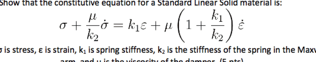

I'm probably not understanding the situation, but I would expect stress and strain to be linearly related up until yield (or some plastic limit for rubber). But the model says some part of the relationship should be exponential? Can you link to where it says this?

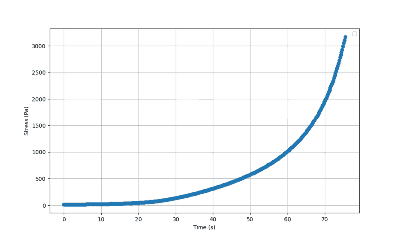

Can you show some of your data and describe the actual setup? Thanks.
This is a compression test that applies a linear displacement to the material (in this case, rubber) over time and records the resulting stress. In my understanding, the exponentially decreasing stress evolution is predicted by the first-order differential equation with respect to stress when the displacement is fixed linearly. However, my experimental results show an exponentially increasing stress for rubber. Below are the results for reference.
