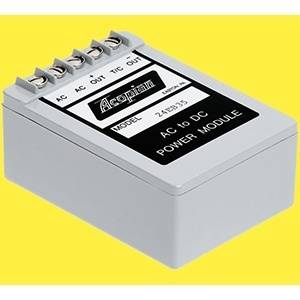

Yeah that could be confusing. The power supply is a set +15V, Ground, -15V connection coming straight from the wall outlet of 120VAC. When I don't have the circuit connected to the power supply, I can measure +15V between the +15V and ground. I can also measure -15V between the -15V connector and ground. When I connect the cables going to the circuit and then retest at the same point as before on the power supply. I get +15V for the +15V and Ground, when I test the -15V and ground I read +1.4V. I can disconnect the circuit from the power supply and I read the normal voltages as in the beginning.
The power supply looks like this but 15V

With the circuits powered off, try measuring the resistance from the -15V input to Ground, and between +15V and -15V on your breadboard and the PCB circuit (power supply disconnected). Do you get similar numbers?
You can also put small resistors in series with the +15V and -15V lines from the power supply, to measure the current being drawn. Size the resistors to give you about 0.5V drop at the nominal current you expect...
