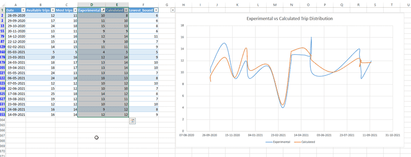

Data looks something like this:
Experimental are trips that have been arranged manually according to the data. Calculated is where I used a formula:
Sqrt ((Available trips - Lowest_bound) +Overlap_Factor) + Lowest_bound
It seems to come very close to the actual number of trips an electric car can have on that day but I don't understand why it comes so close and I don't really understand why I used this formula. Maybe someone can explain if it's just luck or there is some reason for using a square root. I'll probably be asked why this formula at the presentation.

Can I suggest that you attach a full scale screen grab, so we can read the chart?
You don't have to embed it in the post, there's an "Attach files" option (I think it's in the lower right corner of your editor).

It seems to me like your goal is to calculate profits. In that case, isn't the accuracy of your predictions the most important thing? If someone asks you "why did you use this formula", what's wrong with saying "because it works"? You can track sum of residuals squared (see wikipedia) to quantify how good your formula is.
If you really want to prove that a square root is the right functional form, then I suggest you plot your experimental data vs. the "available trips" on a log-log scale. If the slope of this data is nearly 1/2 (particularly for large values of "available trips"), then the square root was good call. This is most useful when you have a large spread in the values of "available trips". This is the standard trick when you're trying to fit a power law of the form ##y = Ax^B##.
