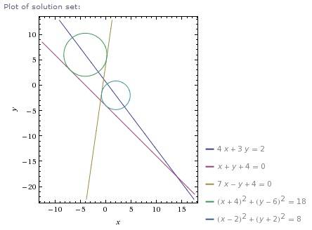

Here is a plot of the three lines and the two circles:
https://www.physicsforums.com/attachments/1008._xfImport
