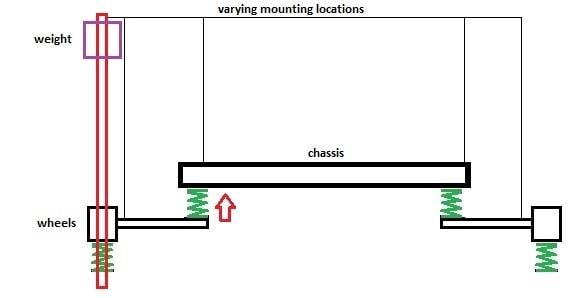

A simple experiment I ran (not sure if it's correct), I took a heavy weight and varied the location where I want to mount my so called jack hammer, basically right near the unsprung part of the suspension seemed the best.
What I noticed the rebound of only 25%, so basically the chassis moved up.

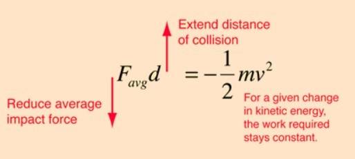

"For example, if a 5 pound hammer is swung at 50 feet per second, then the kinetic energy of the hammer is 5 * 50 * 50 / 64.32 = 194 foot pounds. If this then compresses a forging by 1/8 of an inch, then neglecting rebound, then it is about 194 * 96 or about 18,600 pounds of force on average. This is because 1/8" = 1/96th of a foot, and the average force is foot pounds / feet over which the force acts."

kazx9r said:
but more looking for where the reaction forces would end up
Ultimately, accelerating the sprung mass up.
Forget about a jackhammer for now and imagine a hydraulic piston slowly applying a force between the sprung and unsprung masses: What happens? How different would it be if the hydraulic piston is turned on & off sequentially?
You should do a proper free body diagram.

Edit to add: yes accelerating the mass up as I stated the chassis would move up but by how much? Is the rebound velocity and force the same? The reason I posted the other link about return velocity. If rebound force is less then would we have a net gain of load downwards?That’s really the tough part, a slow moving piston has very little momentum, a free body diagram would just show equal amount of force on wherever the hammer is mounted so there would be no change in load on the vehicle.
But a fast moving hammer is a bit difficult, we need the mass of the weight of the hammer object and velocity of that hammer to find the work done, none of which I have from the Jack hammer specs.

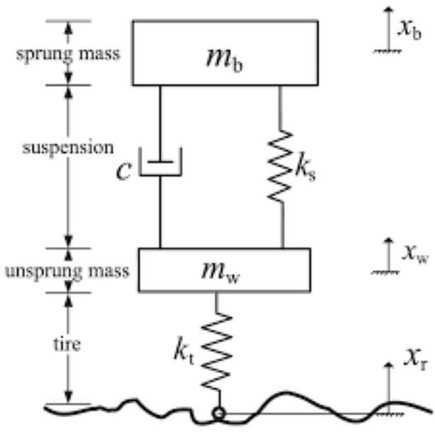

I would solve it as follows:
1) Knowing that a typical car has a sprung natural frequency of 1 to 1.5 Hz, and unsprung natural frequency on the order of 10 Hz, calculate the spring constants and masses.
2) Simplify the free body diagram (FBD) to a quarter car model: a spring for the tire, an unsprung mass, and spring to the body, a damper, and a body mass. Many quarter car models also include a damper in parallel with spring representing the tire. Typical quarter car model:
3) If you really want to analyze a single blow jackhammer, you need the mass and velocity at impact of the mass in the jackhammer that does the hammering. That mass has a momentum and a kinetic energy at impact.
4) Since the impact is steel on steel, the impact duration is short relative to the two natural frequencies.
5) Therefore, I would start with a simplified analysis. All parts in an initial position, and the unsprung mass has an initial velocity calculated from the mass and velocity of the jackhammer mass. Fully analyze this case.
6) The next step is to add a bump in the road. Since you are interested in traction, solve the model for the tire force against the road without the jackhammer.
7) When the models in step 5 and step 6 are fully working, combine them and optimize the timing and force of the jackhammer. Model output is force between tire and road.
8) Now add in the jackhammer reaction force against the car mass, and the body response to the tire/road force.

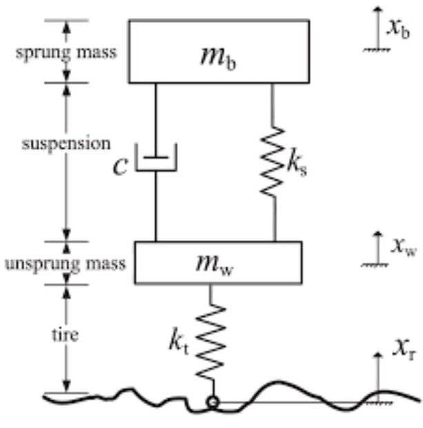

Neither do I, but let the OP figure it out for himself.
I would do the entire analysis in simulation rather than trying to solve it analytically. But that's because I think like an engineer, not a physicist.
Thank you, let me read this a bunch of times before I understand it a bit better, I'll never fully understand it but its helpful.
I'm guessing Kt here would be the spring constant of the tire? for this I would assume something about 1200 lbs/inch. The other variable that comes to mind is, during rebound, that itself would have some kinetic energy, assume most of the rebound would be dampened by the vehicle suspension, so if the hammer repeats the blow, the blow has to overcome the kinetic energy of the rebound and if anything is left over not including the weight on that wheel, then it would have less force, eventually it should level out to zero, is this what is meant by the force will average to zero?
With a jackhammer, the force depends not only on the jackhammer itself but on what it impacts as well.
In post #9, you have a simplified free body diagram (FBD). Between the spring and the damper, you would add your jackhammer. What you know about your jackhammer is the impact energy per blow (46.5 ft.lb/blow or 63 N.m/blow) and the blows per minute (1100 BPM or 0.0545 s/blow). With this, you have the output power ##P## of the jackhammer:
$$P = \frac{63\ N.m}{0.0545\ s} = 1156\ W$$
Since the jackhammer has a 15 A / 120 V motor, it has an input power of 15 A X 120 V = 1800 W, so this gives you an idea of the jackhammer's efficiency.
Back to your FBD, the force acting will be ##F = \frac{P}{v}## or, more precisely:
$$F_j = \frac{P}{\dot{x}_b - \dot{x}_w}$$
Note that theoretically, the force is infinite when both masses travel at the same speed. In reality, something would deform and the force would depend on the displacement. This force is added to the two other forces - the spring and the damper:
$$F_s = k_s(x_b - x_w)$$
$$F_d = C(\dot{x}_b - \dot{x}_w)$$
