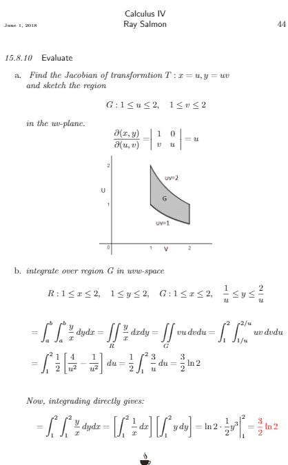

Jacobian of the transformation T:x=u, y=uv
In summary, to graph u= 1, u= 2, uv= 1, and uv= 2 in Desmos, first replace u with x and v with y. Then, enter the functions x= 1, x= 2, y= 1/x, and y= 2/x. Finally, limit the axes to x and y values between 0 and 3 for a good graph. The typeset can be found at the given Desmos plot link.

how do you graph this in Desmos ?
Assume the rest of the calculation is correct
much thank you ahead...:cool:
Do you mean how to use Desmos to graph u= 1, u= 2, uv= 1, and uv= 2?
First, of course, Desmos graphs either y= f(x) or x= g(y) so you have to replace u with x and v with y and solve xy= 1 and xy= 2 for y (or x). that is, enter the functions x= 1, x= 2, y= 1/x, and y= 2/x. I limited the axes to that x and y were between 0 and 3 to get a good graph.
ok here is my eventual typeset
desmos plot is here
https://www.desmos.com/calculator/cmqpsbp85y
