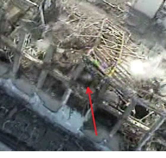

satellite 3 minutes after explosion:
http://www.satimagingcorp.com/galleryimages/worldview-2-fukushima-daiichi.jpg
In the photo at the southwest corner of Unit 3 RB it looks like the SBGT pipe might be severed or at least has some debris laying on it. There is no damage to Unit 4 RB yet. If any of you graphics experts can look at this it may be evidence to rule out Hydrogen from Unit 3 causing the explosion or damage in unit 4 through the common stack.

jim hardy said:

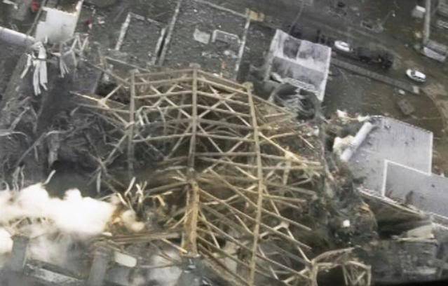

Wow, I missed this picture up until now.
At 3 minutes after explosion there were two distinct and separate sources of steam release: the containment structure and the SFP.
This all but confirms T-Cups theory about the source of the blast coming from under the containment lid.
But the steam is coming from the SFP and the "tool pool". Containment is in the "gap" between the two steam plumes is it not?
Steam has been observed emanating from the "tool pool" side of the containment structure of Unit #3 since the explosion made that area visible but it is a leap to conclude from that visible steam that containment is a blast source isn't it?
We have images of the concrete blocks separating the reactor void from the "tool pool" and they appear to be un-smashed. Given the building damage there was plenty of lateral force to push the side walls of the building out so much. Explosion source inside containment seems illogical to me given what damage we can see. It leaves a question mark about what caused the lateral forces that popped the RB like a concrete balloon. Hydrogen throughout the entire RB seems much more logical imho. Thats just my 2c of course.
  • #9,090
I'm responding to westfield #94104
We have images of the concrete blocks separating the reactor void from the "tool pool" and they appear to be un-smashed. Given the building damage there was plenty of lateral force to push the side walls of the building out so much. Explosion source inside containment seems illogical to me given what damage we can see. It leaves a question mark about what caused the lateral forces that popped the RB like a concrete balloon. Hydrogen throughout the entire RB seems much more logical imho. Thats just my 2c of course.The larger plume of steam is coming from the containment structure - on the east side of the bldg in the center of the building.
The smaller plume is coming from a place south of that - right where we would expect the spent fuel pond to be.The refueling trough (cattle chute) is between the containment structure and the SFP.
I don't know about a "tool pool" do you mean the equipment pool?
That would also be on the east side of the bldg, north of the containment structure.
