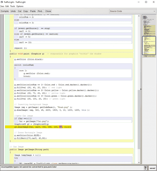

Hello, I'm having trouble with moving an object using an image. I want my image "Car" to move left and right when I press one of the JButtons. As you can see, I included a blue rectangle to kind of show you what I mean by "moving". Here is the code for the Blue Rectangle.
Java:
private int carY = 150;
Java:
if (event.getSource()  == stop)
            carY -= 15;
        else if (event.getSource() == caution)
            carY = 15;
        else
            carY += 15;
Java:
 g.setColor(Color.BLUE);
        g.fillRect(170,carY, 60,90);
If you click on "Go", the rectangle will move up at 15
Java:
carY += 15;
. I'm confused on how would you get the image "Car" to move instead of the rectangle.
Here is the Car image code:
Java:
 private Image Car = null;
Java:
//gets Car image
        if (Car ==null)
            Car = getImage("Car.png");
        Graphics2D g2 = (Graphics2D)g;
        g2.drawImage(Car, 150, 350, 100, 50, this);
So, I want to insert carY into
Code:
but you can't because I get an error: "Incompatible types: int cannot be converted to java.awt.Color". So, I don't know how to connect my image with the actionListener to where if I press a JButton, it will move the car image.

Borg said:
Can you post part of the stack trace error that you're getting? It helps to see where in the program it's failing.
You mean like this? (In the picture/attachment below).
Maybe to help clarify more. This part in the code for the rectangle:
Java:
This works fine, but instead, I want the carY in the image:
Java:
g2.drawImage(Car, carY, 150, 350, 100, 50, this);
This doesn't work, as it gives an error, "Incompatible types: int cannot be converted to java.awt.Color."
carY is used so that when I click a JButton, and depending on which JButton I click, the object (in this case, I want the image) to move using this:
Java:
            carY -= 0;
            carY -= 5;
        else
            carY += 15;
So I want carY to be used for the image, not the rectangle. The rectangle was just an example. I hope that simplified my question a little more.

Sorry for the delay. I downloaded the zip and modified it to work in my environment this morning. When you mentioned an error in your first post, I thought that you were having trouble compiling but the code does compile and run.
As for getting the car to move, you are applying the position change to the road's graphic position and not the car's. Change these two lines to get the car to move (original code left as commented):
Java:
        g2.drawImage(Car, carY, 350, 100, 50, this);
//      g2.drawImage(Car, 150, 350, 100, 50, this);
        // Draws Rectangle Image
        g.fillRect(170, 150, 60, 90);
//      g.fillRect(170, carY, 60, 90);
Likes FritoTaco
