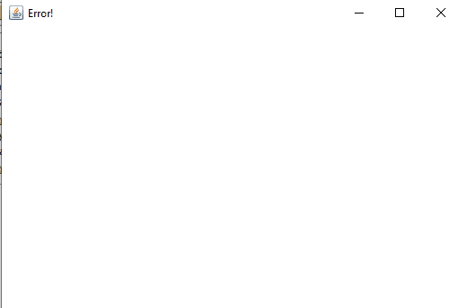

I have written a program that will launch three JFrame windows if the user enters the correct things everywhere. In case there is a mistake, an error window will open, and then after 3s, the user will be re-directed to the window where he made the error.
The flowchart is attached.
Everything is working fine except the JFrame created by makeGUI_4().
The function makeGUI_4() looks something like this:
Java:
private void makeGUI_4() {
        try {
            jfrm4 = new JFrame();
            jfrm4.setLayout(new FlowLayout());
            jfrm4.setBounds(50, 50, 527, 351);
            jfrm4.setDefaultCloseOperation(JFrame.EXIT_ON_CLOSE);
            jfrm4.setTitle("Error!");
            jlb1 = new JLabel("Wrong date/time.");
            jlb2 = new JLabel("Program restarting...");
            jfrm4.add(jlb1);
            jfrm4.add(jlb2);
            jfrm4.setVisible(true);
            Thread.sleep(3000);
            jfrm4.setVisible(false);
            makeGUI_2();
        } catch (InterruptedException ex) {
            Logger.getLogger(BuildGUI.class.getName()).log(Level.SEVERE, null, ex);
Here, jlb1 and jlb2 are two JLabels declared as class variables. jfrm4 is a JFrame also declared as a class variable.
I want a simple window that shows:
"Wrong date/time."
and then the thread goes to sleep for 3s, and calls makeGUI_2().
This is what I get when the user makes an error and makeGUI_4() is called:
The JLabels just don't appear in the window.
Where am I going wrong?

Could this be a race condition? The code I've seen used an invokeLater() setup to allow the GUI to get created before its displayed. Also pack() and setVisible(true) is usually the very last thing you do.

I found out the error. It is a simple logical error.
As @jedishrfu said, jfrm4.setVisible(true) is being executed at the end. As a result, the window is being created after a delay of 3s, but as soon as the window is created, the next command, jfrm4.setVisible(false) is executed, and the window vanishes. Hence, I was being unable to see the output. Commenting out the last code solved the problem.
Basically I wanted the window to stay for 3s before disappearing, and that's why I put the Thread.sleep() after setVisible(true). Let's see how I can do that now.

You can not create the JFrame, add stuff to it, then sleep all in a row. Here is what is happening in order:
Create JFrame, which creates an actual window in Windows and sets it up.
You add two Labels to the object, which causes a repaint event to go into the event queue
You then sleep in your thread
Your method returns and goes back into the event loop which then gets the queued repaint event, which then draws
You're expecting the setVisible to be a synchronous function that will instantly show you the state of the window, but that's now how these windows work, they're almost entirely event driver and you are IN the event loop when you create this window.
You need to get your head around event driven code. You'll need this in order to have the window stick around for three seconds, you don't want to stop your UI thread for stuff like that, you want to register a timeout event, which then calls a function to dispose of your window.
