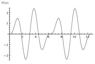

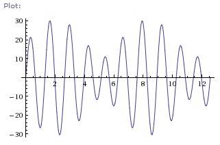

Express the solution of the given initial value problem as a sum of 2 oscillations. Throughout, primes denote derivatives with respect to time t. Graph the solution function x(t) in such a way that you can identify its period.
2. x"+4x=5sin3t x(0)=x'(0)=0
4. x"+25x=90cos4t x(0)=0 x'(0)=90

2.) We are given the IVP:
$$x"+4x=5\sin(3t)$$ where $$x(0)=x'(0)=0$$
The first thing we want to do is find the associated homogeneous solution $$x_h(t)$$. We see that the characteristic equation is:
$$r^2+4=0$$
Thus, the characteristic roots are:
$$r=\pm2i$$
and so we may state:
$$x_h(t)=c_1\cos(2t)+c_2\sin(2t)$$
We may choose, using a linear combination identity, to write this solution as:
$$x_h(t)=c_1\sin\left(2t+c_2 \right)$$
Now, using the method of undetermined coefficients, we may look for a particular solution $$x_p(t)$$ of the form:
$$x_p(t)=A\sin(3t+B)$$
Differentiating twice with respect to $t$, we find:
$$x_p''(t)=-9A\sin(3t+B)$$
Substituting the particular solution into the original ODE, we may now determine the parameters $A$ and $B$:
$$\left(-9A\sin(3t+B) \right)+4\left(A\sin(3t+B) \right)=5\sin(3t)$$
$$-5A\sin(3t+B)=5\sin(3t+0)$$
Hence, we see that:
$$A=-1,\,B=0$$
and so:
$$x_p(t)=-\sin(3t)$$
By superposition, we may state the general solution to the ODE as:
$$x(t)=x_h(t)+x_p(t)=c_1\sin\left(2t+c_2 \right)-\sin(3t)$$
Now, to determine the solution satisfying the initial values, we need to differentiate the general solution with respect to $t$ to obtain:
$$x'(t)=2c_1\cos\left(2t+c_2 \right)-3\cos(3t)$$
Now we may write:
$$x(0)=c_1\sin\left(c_2 \right)=0$$
$$x'(0)=2c_1\cos\left(c_2 \right)-3=0$$
From these equations, we may observe that $c_1\ne0$, and so we have:
$$c_1=\frac{3}{2},\,c_2=0$$
Thus, the solution satisfying the IVP is:
$$x(t)=\frac{3}{2}\sin(2t)-\sin(3t)$$
A plot of the solution shows its period is $T=2\pi$:

4.) We are given the IVP:
$$x"+25x=90\cos(4t)$$ where $$x(0)=0,\,x'(0)=90$$
As before, we first want to find $x_h(t)$. We see the associated characteristic equation is:
$$r^2+5=0$$
and so:
$$r=\pm5i$$
Thus, the homogeneous solution may be written:
$$x_h(t)=c_1\cos\left(5t+c_2 \right)$$
Next, we may use undetermined coefficients to find a particular solution of the form:
$$x_p(t)=A\cos(4t+B)$$
$$x_p''(t)=-16A\cos(4t+B)$$
Substituting into the original ODE, we find:
$$\left(-16A\cos(4t+B) \right)+25\left(A\cos(4t+B) \right)=90\cos(4t)$$
$$9A\cos(4t+B)=90\cos(4t+0)$$
From this we determine:
$$A=10,\,B=0$$
and so we have:
$$x_p(t)=10\cos(4t)$$
By superposition, we may the give the general solution to the ODE as:
$$x(t)=x_h(t)+x_p(t)=c_1\cos\left(5t+c_2 \right)+10\cos(4t)$$
$$x'(t)=-5c_1\sin\left(5t+c_2 \right)-40\sin(4t)$$
Now we may write:
$$x(0)=c_1\cos\left(c_2 \right)+10=0$$
$$x'(0)=-5c_1\sin\left(c_2 \right)=90$$
Solving both for $c_1$, we find:
$$c_1=-\frac{10}{\cos\left(c_2 \right)}=-\frac{18}{\sin\left(c_2 \right)}$$
$$5\sin\left(c_2 \right)=9\cos\left(c_2 \right)$$
$$\tan\left(c_2 \right)=\frac{9}{5}$$
$$c_2=\tan^{-1}\left(\frac{9}{5} \right)$$
$$c_1=-\frac{10}{\cos\left(\tan^{-1}\left(\frac{9}{5} \right) \right)}=-2\sqrt{106}$$
Thus we may state the solution satisfying the given IVP is:
$$x(t)=-2\sqrt{106}\cos\left(5t+\tan^{-1}\left(\frac{9}{5} \right) \right)+10\cos(4t)$$
Using the identity $$\cos(\theta-\pi)=-\cos(\theta)$$, we may write this solution as:
$$x(t)=2\sqrt{106}\cos\left(5t-\left(\pi-\tan^{-1}\left(\frac{9}{5} \right) \right) \right)+10\cos(4t)$$
