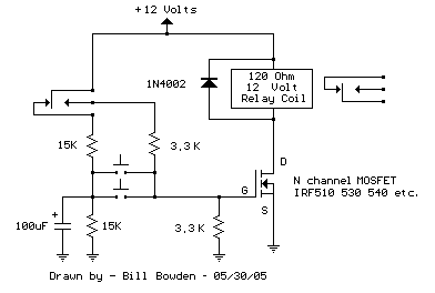

Do you think this circuit could be adapted for my use?
A reed relay which is activated for about (14 pulses)*(1/38000) = 368 uS.
This relay (which is switching on and off as expected) could be used to power another circuit such as:
My question is, do you think that substituting a 368uS "push" would even give adequate time for the capacitors to charge, and therefore switch correctly? Obviously the circuit was designed for humans pushing the button, and I expect most people push down on a button for more than 368uS.

If you have two latching relays, it seems you could use one for the direction control (for both relays), and one for your functionality. I haven't thought it all the way through, though, so I could be wrong.
You could use a flip-flop (FF) as long as it always stayed powered, and an H-bridge IC to drive the coil of a single latching relay...

Thanks guys. Any idea if that circuit could work (before I buy the components)?

Rather than worry about using the IR receiver, I think it would really simplify the circuit to use a circuit I already have using a reed relay to switch something else on or off.
How could I modify the above circuit to just use a single toggle from the reed relay instead of the IR receiver?
