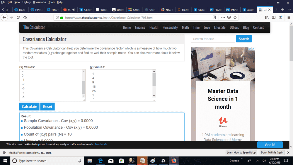

I think it has to see with the fact that ##(X-\mu_X)(Y- \mu_Y)## is alternatingly positive and negative, i.e., neither overwhelmingly positive nor negative. So there is no clear sense of either x increases with y nor x decreases with y, but I am still trying to get a better feel for the term. EDIT: In a more formal sense which I don't fully get yet) Cov(X,Y) is a quadratic form and we can show Cov(X,Y)= -Cov(X,Y), forcing it to equal 0.
EDIT2: Here is a screenshot of a Covariance calculator for the pair ##(X, Y=X^2) ## where correlation is 0. Data points X=( 1,2,3,4,5,-1,-2,-3,-4,-5) and Y=( 1,4,9,16,25,1,4,9,16,25)
EDIT2:

WWGD said:
AFAIK uncorrelated , implying Cov(X,Y)=0 means there is no "clear pattern of change of Y when X changes" .
That is not a good intuition. Suppose (X,Y) jointly take on the following values, each with probability 1/5: (-2,-2), (-1,-1), (0,0), (1,1), (2, -3).
##\mu_X = 0 ##
##\mu_Y = -1##
## E(X,Y) = 0##
##COV(X,Y) = 0##
In this case, knowing ##X## completely determines ##Y##.
In the above example, ##X## and ##Y## are independent. Neither independence nor zero correlation rule out a deterministic relationship ( a "clear pattern") relating two random variables.
(It's also possible to give examples of two random variables that are uncorrelated but not independent. )
A better intuition about COV(X,Y) is that it has to with with approximating the relationship between ##X## and ##Y## by a linear equation.
