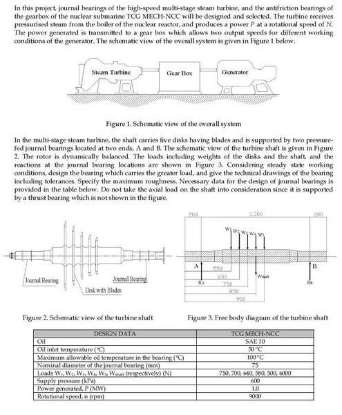

Dear everybody here,
Here is a problem to solve, from shigley handbook for Machine design, it's about Journal bearing design for the shown shaft in the attachment, i know how to design the journal bearing, but i am a little bit confused about how to get the reaction forces at the two points A and B, and the shaft load at those points to consider into the bearing design
The loads at x-direction are neglected, and steady state working conditions, getting the reactions can be by getting ∑Fy=0 ?, if so, what about the shaft loads at those points?
Please take a look at the attached picture, it has the whole given data, i only need the procedures to get the loads right
will appreciate your help,
Thanks

Would you not just take moments about A to get the reaction at B, and/or vise-versa?
yes, and what about the shaft load at the points A and B?, how to get?
it will be equal to the reaction force i get?, at A and B?
The reaction forces at A and B balance the weight of the shaft and the weight of the disks. ∑Fy=0.
If the reaction force at A ( or B ) is found, then by using ∑Fy=0, the reaction at the other location is found.
Okay bits, thanks for your help
