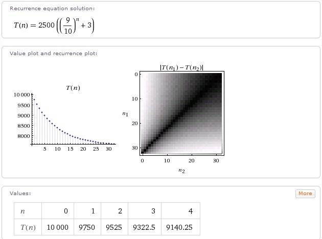

Solving this system, we find $$k_1=7500,\,k_2=2500$$ and so we have:
$$T_n=7500+2500(0.9)^n$$ and low it is easy to see that:
$$\lim_{n\to\infty}T_{n}=7500$$
Here is a plot of the recurrence:
https://www.physicsforums.com/attachments/823._xfImport
