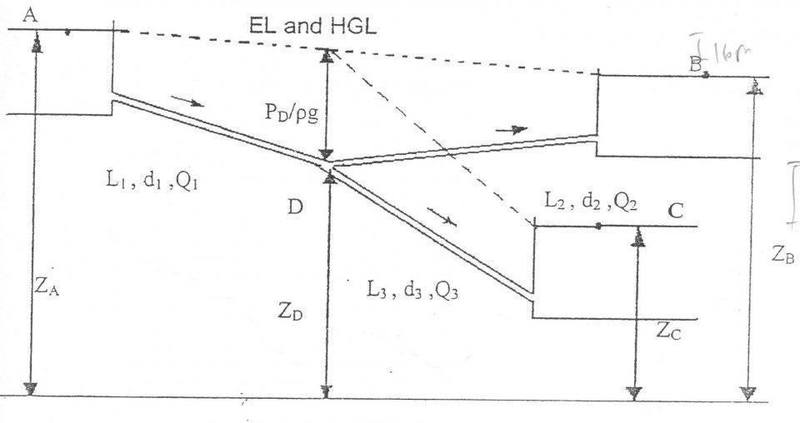

Messy threads, this one and the -- 98% identical to this one -- other thread which I find a lot more sensible.
The note in post #4 here clarifies a few things -- and messes up others.
  • Haru fixed the first 'If P is below' which should have been 'at'.
  • The term 'elevation of P' confused me no end
I'm not used to working in terms of 'head', only with pressure, but I think 'elevation of P' is the same as ##H_J## and then ##P_D## is understandably the pressure at D .
What P is I find declared nowhere (whatever happened to 'all variables and given/known data' in the template -- my addition: including the dimensions ) :rolleyes: ?
That would make for ##\ \ H_J = P = Z_D + P_D/(\rho g)\ \ ## (so not ##\ \ Z_D + P_D/\rho \; g \ \ ##, nitpicking, I know) and now I'm still a bit dazzled but back in the race.​
  • 'the pipes are sufficiently long that we can neglect minor losses and velocity head' also is cryptic to me. long ? or wide ? The idea is to ignore friction loss (viscosity = 0) ? But why ignore 'velocity head' - when ##V^2/g## is featuring clearly in the other thread ? Or is velocity head something else than this term from the Bernoulli equation ?

I might be starting to get what is going on here. As you say, we have no definition of P. I was taking it to be interchangeable with D, but I now think it is an energy level associated with D.
The diagram in the other thread shows the physical arrangement of pipes, plus a schematic "energy line". Note that the slopes are not the same between the two. In the schematic there is an energy level HJ associated with the junction.
There is a similar energy diagram in the current thread, this time using dashed lines. I suggest "P" in the text refers to the energy level at D. If this is equal to that at B then there is no flow to or from B, etc. That makes sense.
Now, none of these diagrams can be handled with simple Bernoulli. Either there is viscosity or the flows will accelerate. I'm not sure which of those the author assumes, maybe it doesn't matter.
