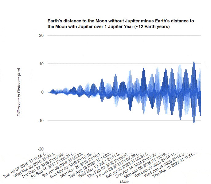

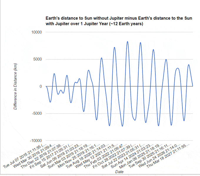

The link I provided in post #11 above is of an n-body simulation.
I ran the simulation twice, each time recording the Earth-Sun distance on a daily basis.
In the first simulation, I included the Sun, all planets (Pluto too!), and the Moon.
In the second simulation, I set Jupiter's mass to 0.
I ran it two more times, this time recording the Earth-Moon distance.
Here are graphs of the data.
You clearly see the yearly / monthly variation as dominant effect: The presence of Jupiter deforms the orbit a bit. A magic constant position of Jupiter would make the orbit more and more eccentric over time, but as Jupiter's position changes, the effect points in different directions over the 12-year cycle, averaging out.
For Moon/Earth, we have such an averaging effect over 1 year already.
