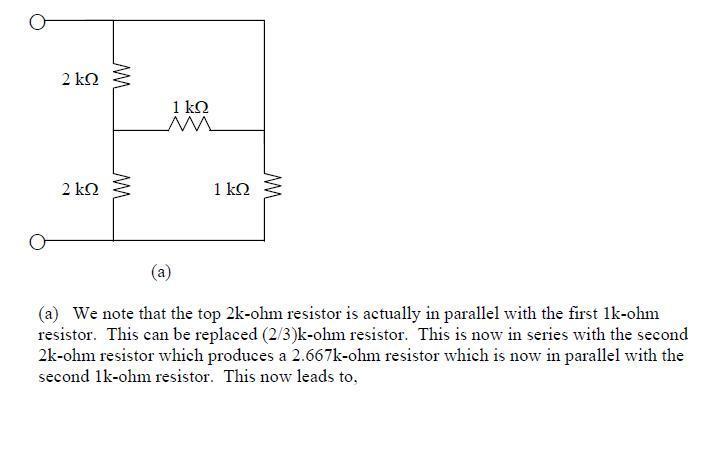

ok I've been doing some problems but i can't seem to figure out how the top 2k ohm resistor is in parallel with the 1k ohm resistor. can anyone explain this to me?
http://dl.dropbox.com/u/4222062/parallel.PNG
aha i see. was actually very simple then. thanks alot.
