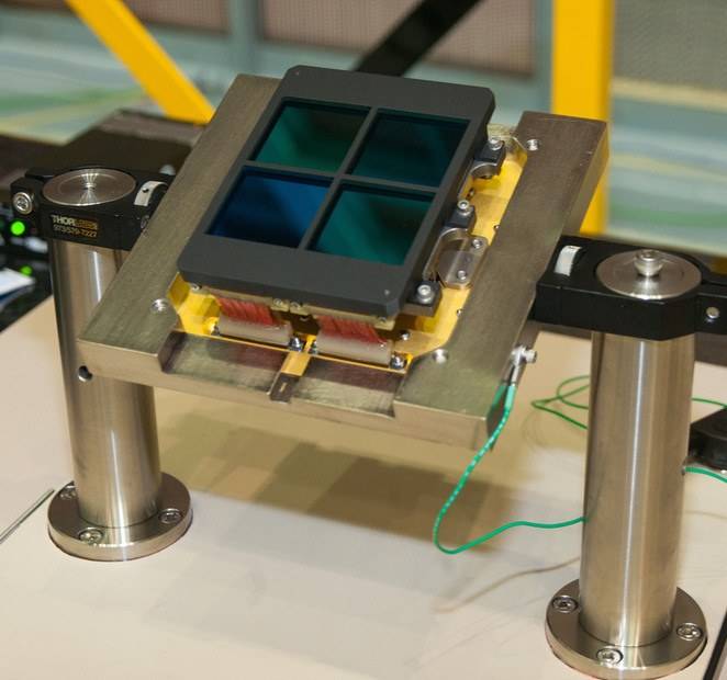

I've read the NIRCam instrument uses HgCdTe imaging sensors...
"JWST NIRCam has ten 2K × 2K HgCdTe detectors"
https://jwst-docs.stsci.edu/jwst-ne...rcam-instrumentation/nircam-detector-overview

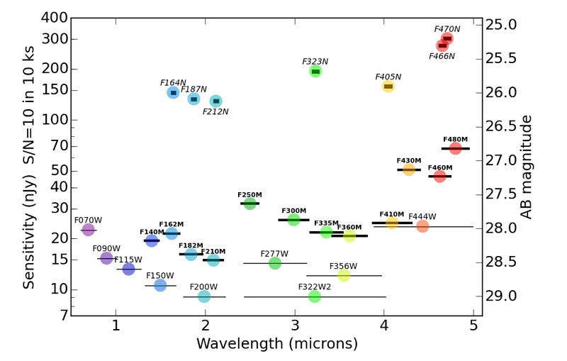

I found this chart which displays the relative sensitivity of the NIRCam sensor for different filters and wavelengths:

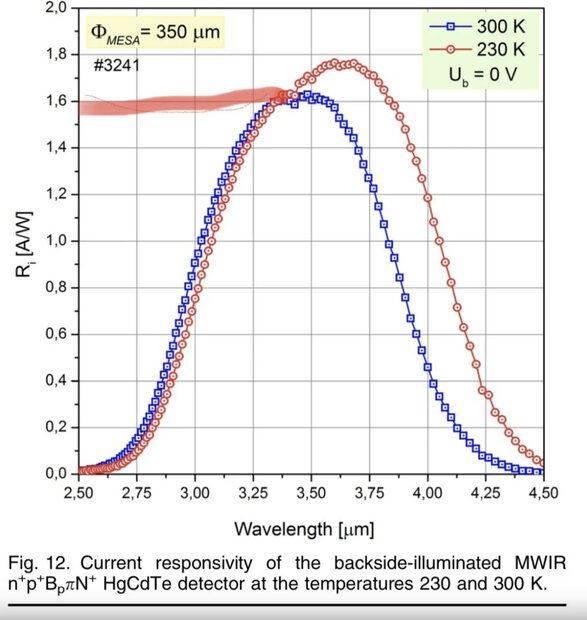

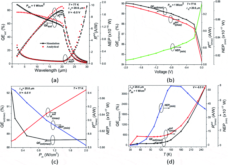

I tried to find a chart showing the "current responsivity" at different temperatures for the actual NIRCam sensor, but I couldn't locate one, so I pulled this chart from a paper written on a different HgCdTe photodiode which shows 1.6 amps per watt of 3.5 micron light incident on the sensor while the sensor is 300 Kelvin (would've posted the actual NIRCam specs if I could find them):
https://www.researchgate.net/publication/343856156_Higher_Operating_Temperature_IR_Detectors_of_the_MOCVD_Grown_HgCdTe_Heterostructures
https://www.speakev.com/cdn-cgi/image/format=auto,onerror=redirect,width=1920,height=1920,fit=scale-down/https://www.speakev.com/attachments/5000b9e5-011d-4ef0-af59-bedb15ff822e-jpeg.156575/
My question is this:
Considering that the 2nd Law of Thermodynamics is inviolable, and so the sensor shouldn't be able to "detect" an object which is colder than the imaging sensor, if the sensor above from figure 12 were used in NIRCam (since I can't find the actual NIRCam responsivity specs), what physical effect would prevent a 3.5 micron photon from kicking an electron from the valence band to the conduction band in the 300k sensor, if the photon were emitted as black body radiation from a 299k object? In other words, how would a valence electron in the sensor determine the temperature of the emitting object from the arriving 3.5 micron photon's characteristics such as wavelength before either being kicked or not kicked to the conduction band, in order to remain consistent with the 2nd Law?

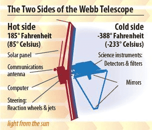

The near-infrared instruments (NIRCam, NIRSpec, FGS-NIRISS) have now reached their target range from 34 to 39 K by cooling passively.
Does anyone have access to the engineering "current responsivity" charts for the actual NIRCam sensors at different operating temps?
For the 300k sensor data shown above, to maintain consistency with the 2nd Law how does the 300k HgDcTe valence electron "measure" whether an incoming 3.5 micron photon comes from a 299k object or 301k object? To satisfy the (assumed inviolable) 2nd Law, all the "299k" 3.5 micron photons must be blocked or prevented from elevating internal photoemission electrons from valence to conduction.

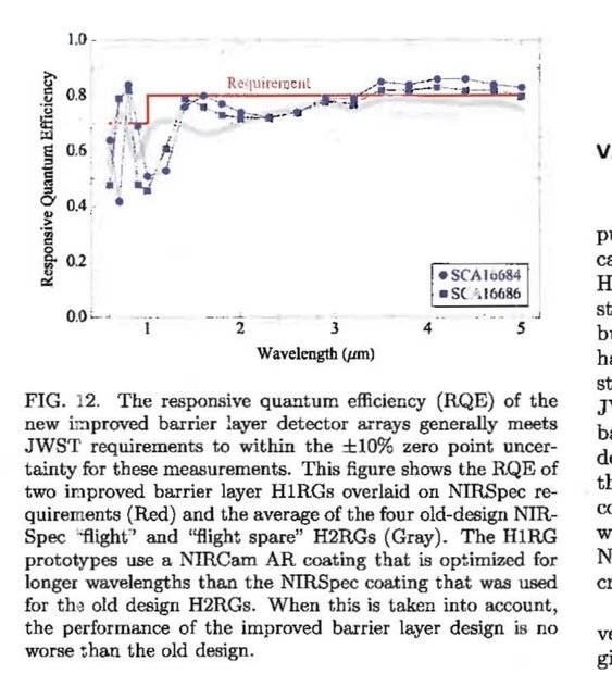

Thanks for those links. I did find what appears to be a product page for the NIRCam imaging sensors here:
http://www.teledyne-si.com/products/Documents/TSI-0855 H2RG Brochure-25Feb2022.pdf
The page mentions a quantum efficiency for 3500nm (3.5 micron) light equal to or greater than 70% though it doesn’t mention what temperature the sensor was operating at when it achieved that efficiency.
Also found this:
https://core.ac.uk/download/pdf/10569376.pdf

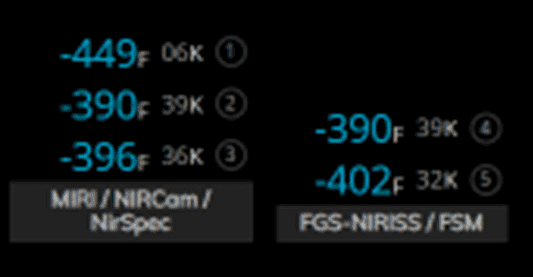

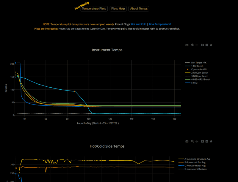

The instrument has been at a steady 39K since about day 90 or so according to Where's Webb.
If that helps

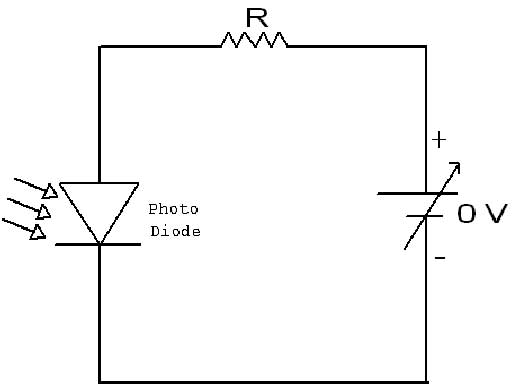

I’m a bit surprised by these answers as I am fully assuming the 2nd Law of Thermodynamic is inviolable and also that it forbids obtaining “useful work” by transferring energy from a cold reservoir to a hot one.
So if we have a shaded-from-the-sun 299k object emitting some 3.5 micron black body radiation, if any electron hole pairs were produced in a 300k detector with non-zero quantum efficiency for 3.5 microns at that operating temperature, wouldn’t that be forbidden? That’s why I asked earlier about the difference between 3.5 micron photons from a 299k source vs 3.5 micron photons from a 301k source.
On the sensor, the photodiodes are wired to charge a small capacitor at each pixel site, & it takes work to charge a capacitor because one obtains useful work when that capacitor discharges.
Considering the diagram below of a photodiode operating with zero bias voltage wired to charge a capacitor, won’t the 2nd Law forbid creating any electron hole pairs which would in turn charge that capacitor, if the 299k emitter emits 3.5 micron black body radiation and the 300k photodiode has non-zero quantum efficiency for 3.5 micron light at that operating temperature? I thought the 3.5 micron black body photon emitter would need to be at least 301k to charge a 300k photodiode which is wired up as shown below, in order to satisfy all the requirements of the 2nd Law.
Wouldn’t the Carnot efficiency for a 300k cold side and a 300k hot side be exactly 0%?
Diagram from: https://www.pantechsolutions.net/characteristics-of-optical-photo-diode-in-zero-bias/amp
By the Fluctuation-Dissipation theorem,
https://en.wikipedia.org/wiki/Fluctuation-dissipation_theorem
Both the diode and the resistor will constantly generate a fluctuating current. If the object you want to detect is in thermal equilibrium with your electronic device, you won't be able to detect a change in this fluctuating current, although some of the current will be due to the object. If the temperature of the object is less than that of the device, you might in principle detect that the temperature of you device (and fluctuating current) goes down, but usually the heat capacity of your device is usually to large for this to be detectable. If the temperature of the object is higher, you will be able to detect a signal above the random fluctuation. The smaller the temperature difference, the longer your measuring time will have to be to detect the signal above the thermal noise.
Likes Oldman too, Devin-M and pinball1970
The second law of thermodynamics works on the average of a large number of events. It doesn't apply to individual photons. Suppose I have an object at 299K next to a detector at 300K. Both objects are radiating. Slightly more energy flows from the 300K detector to the 299K object than flows back the other way. But radiation is still traveling in both directions, and photons flowing from the 299K object to the 300K detector can still be detected.
But as I and others have pointed out, this is not really relevant for the JWST. The NIR detectors are operating at ~40K and the MIRI detectors at 6K.
Likes russ_watters and Devin-M

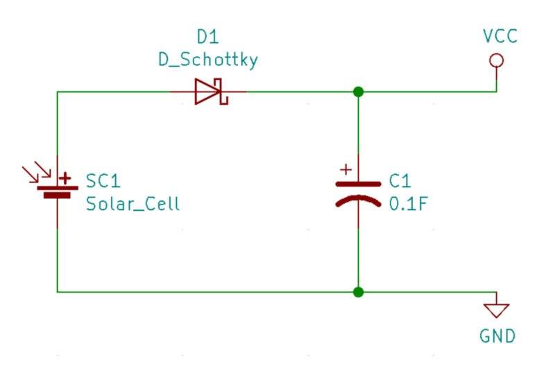

@DrDu Any comment about this page claims adding a 2nd diode stops the capacitor from discharging back into the photodiode?
it says “The simplest solar-powered circuit to charge a supercapacitor is made by just connecting the capacitor to the solar panels. The only other important component is a diode to stop the supercapacitor from discharging back into the solar panels.
See diagram below, photodiode labeled SC1 Solar_Cell, Capacitor to be charged labeled C1, additional diode to stop the backflow into photodiode labeled D1, Positive terminal to power load from the capacitor labeled VCC and negative terminal to power the load from capacitor labeled GND:
http://www.bitbanging.space/posts/solar-charged-supercapacitos
You think this describes a near thermal equilibrium situation?

Thanks for that answer. So if we have this circuit, where the photodiode (SC1) is 300k, gets 1.6 amps per watt of 3.5 micron light while operating with zero bias voltage (photovoltaic mode), with a Schottky capacitor to prevent back flow out of the capacitor:
& the HgCdTe photodetector has this measured amps per watt of 3.5 micron light with zero bias voltage while the detector is 300k:
“Current responsivity (RI) of the backside-illumi- nated MWIR n+p+BppN+ HgCdTe detector is pre- sented in Fig. 12. The mesa diameter of the element is about 350 lm. The measurements were per- formed at temperatures of 230 K and 300 K and without the application of bias voltage (Ub = 0 V).”
https://www.researchgate.net/profile/Pawel-Madejczyk-2/publication/343856156_Higher_Operating_Temperature_IR_Detectors_of_the_MOCVD_Grown_HgCdTe_Heterostructures/links/6086b5a62fb9097c0c0d3442/Higher-Operating-Temperature-IR-Detectors-of-the-MOCVD-Grown-HgCdTe-Heterostructures.pdf?origin=publication_detail

So then I have a little thought experiment. Suppose it’s during the commissioning phase, and I want to predict the outcome of 4 experiments based on observing 2 different temperature portions of the lunar surface with the primary mirror either folded or unfolded…
The telescope detectors are still 300k, operating in photovoltaic mode with a Schottky diode to prevent back flow out of the capacitor (detectors haven’t fully cooled), the primary mirror side wings are still folded (primary mirror isn’t yet full size), and the telescope aims at a 301k patch of the night side of the moon and takes a 1 minute exposure, and in so doing the sensor is exposed to 3.5 micron photons from the night side moon surface…
In this case the Carnot efficiency is 0.33%, so the capacitor can build up a useful charge, so the individual 3.5 micron photons hitting the sensor are doing net work on the capacitor in the sensor, charging it, because a Schottky diode prevents back flow out of the capacitor.
Now the telescope swivels to a 300k patch of the moon for another 1 minute exposure. The carnot efficiency is 0% so the capacitor can’t be charged and the individual 3.5 micron photons hitting the sensor from the moon aren’t doing net work on the capacitor, despite the presence of the Schottky diode.
Then the telescope swivels back to the 301k patch of the moon surface, folds out the side mirror wings so the primary mirror area has increased compared to the 1st observation. The carnot efficiency is back to 0.33% so the individual 3.5 micron photons do net work on the capacitor, and the mirror is larger so more 3.5 micron photons from the moon strike the sensor during the 1 minute exposure so more net work is done in total on the capacitor than the 1st test.
Then the telescope swivels back to the 300k patch of the moon. Since the mirror wings are now folded out, more 3.5 micron photos hit the sensor than during the 1 minute 300k test with folded wings, but since the carnot efficiency is 0% on this test, these individual 3.5 micron photons don’t do net work on the capacitor, despite there being more of them than the wings folded test.
So to summarize my predictions,
1) 300k sensor 301k nightside moon, mirror wings folded, capacitor is charged

I calculated the surface area for one of the JWST sensors is approximately 12.9cm^2.
I used the Planck radiation formula for a 300k black body, 0.95 emissivity, 12.9cm^2 and a radiation wavelength range from 3400nm to 3600nm and get 0.00019W of radiated power for that wavelength range which is 0.034% of the total radiated power.
http://hyperphysics.phy-astr.gsu.edu/hbase/quantum/radfrac.html
I calculated the spectral responsivity of a 300k HgCdTe panel from figure 12 in this paper is 0.0003 amps from 0.00019W of 3.5 micron light.
I found the typical reverse leakage current of a particular Schottky diode is 0.00000065 amps with 5 reverse volts at 298K from this datasheet:
https://www.st.com/resource/en/datasheet/bat20j.pdf
When I subtract the max expected 0.00000065 amps reverse current through the Schottky diode from the 0.0003 amps forward current into the capacitor from the spectral responsivity of the HgCdTe panel from the 0.00019W of 3.5 micron photons from the 12.9cm^2 300k black body in close proximity of the 300k 12.9cm^2 HgCdTe photovoltaic panel, I calculate a net current into the capacitor of 0.00029 amps.
I assume this is a mistake since the Carnot efficiency for the setup is 0%. On which step did I mess up the calculations?
Circuit diagram for reference:

I calculated the spectral responsivity of a 300k HgCdTe panel in zero bias photovoltaic mode from figure 12 in this paper is 0.0003 amps from 0.00019W of 3.5 micron light.
