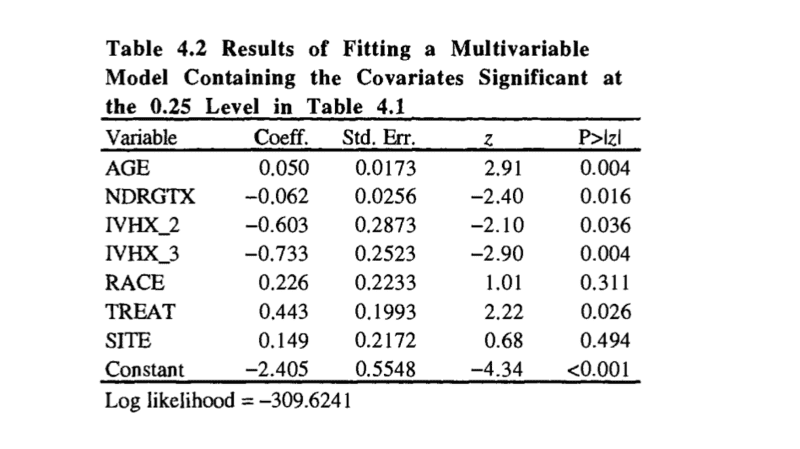

And here is the output for the multivariate equation after univariate analysis has indicated that how to build the multivariate model
Now the usual strategy is simply to drop variables that are not statistically significant.
They said that because SITE is randomized, we cannot drop it. Why? It wasn't explained in the text.
Is it because it is a potential confounder? But clearly from the pval, we don't see it associated with the outcome. So it doesn't seem to confound anything.
