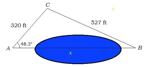

Here is the question:
Points A and B are separated by a lake. To find the distance between them, a surveyor locates a point C on lan?
Points A and B are separated by a lake. To find the distance between them, a surveyor locates a point C on land such that angle CAB = 48.3°. He also measures CA as 320 ft and CB as 527 ft. Find the distance between A and B. (Round your answer to one decimal place.)
Thank you very much for the help!
I have posted a link there to this topic so the OP can see my work.
Mathematics news on Phys.org
Hello Keito,
First, let's draw a diagram:
We have let $x$, measured in ft, denote the distance between $A$ and $B$.
Using the Law of Sines, we may state:
$$\frac{\sin(B)}{320}=\frac{\sin\left(48.3^{\circ} \right)}{527}$$
Hence:
$$B=\sin^{-1}\left(\frac{320}{527}\sin\left(48.3^{\circ} \right) \right)$$
And so:
$$C=180^{\circ}-A-B=180^{\circ}-48.3^{\circ}-\sin^{-1}\left(\frac{320}{527}\sin\left(48.3^{\circ} \right) \right)=131.7^{\circ}-\sin^{-1}\left(\frac{320}{527}\sin\left(48.3^{\circ} \right) \right)$$
Rather than approximate this angle now, let's wait to round until the very last step. (Wink)
Now, using the Law of Sines again, we may state:
$$\frac{x}{\sin(C)}=\frac{527}{\sin\left(48.3^{\circ} \right)}$$
Hence:
$$x=\frac{527 \sin \left(131.7^{ \circ}- \sin^{-1} \left( \frac{320}{527} \sin \left(48.3^{ \circ} \right) \right) \right)}{ \sin \left(48.3^{ \circ} \right)} \approx682.6\text{ ft}$$
